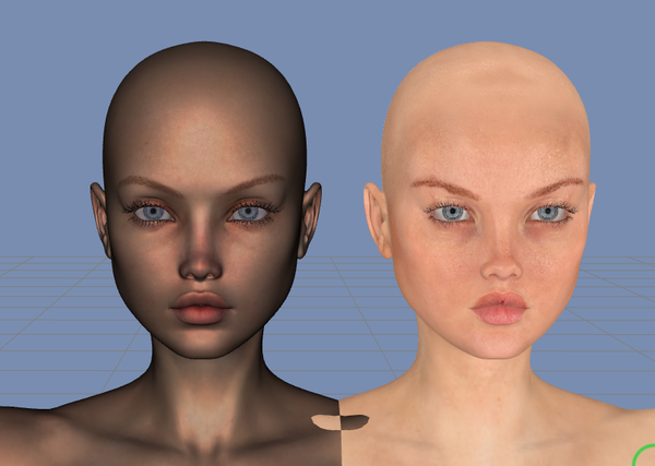

I was loading a base G2F and it looked....not right.
Same with V6....
Am I just addled from too much mesquite smoke?
806 x 573 - 370K
    No, that's not the default G2F. Looks like your base G2F may be corrupted....did you resave it with a morph or anything like that?
  • ScavengerScavenger Posts: 2,677
    Not that I'm aware of.
    Dim should be able to uninstall and reinstall, right?
    Yep it should. I've seen this happen before, just trying to reach back through my bad memory to figure out where. It has something to do with a character morph loading with your default for some reason...argh I can't remember. Will try to figure out.
    For what it's worth, this is image of default Genesis 2 Female base and default Victoria 6. Definitely different.
