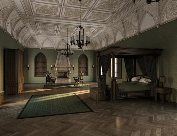

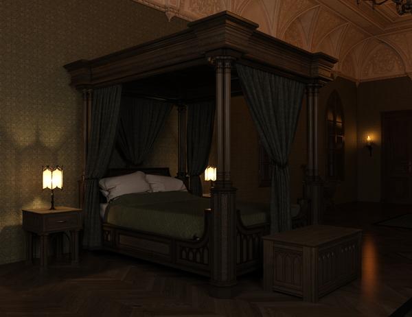

  • kathrynlochkathrynloch Posts: 378
    I'm doing something very similar right now. I think it is possible. First what emission settings are you using?
    Since light itself travels in a straight line until it hit something and bounces, it really doesn't go around corners. You see the cheat all the time in the movies when they have the light from no where lighting the actors eyes/face.
    What I've been doing is working with primitives and making them emissives and tweaking various settings, including scale, using nulls and having the primitive pointing at the subject while still maintaining an ambient light. Lot's of tweaks and spot renders, but I'm definitely seeing progress.
    This is my first render with a single light source with iray - I'm working on a different one right now. ;)
    1031 x 859 - 252K

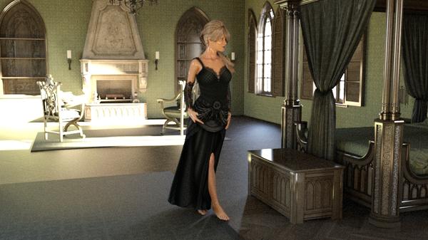

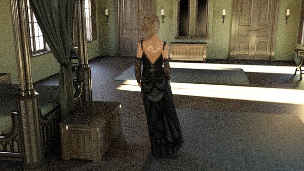

    And this is the render I just made. It's only a partial because it was taking to long for me, but as you can see the single light source is lighting the scene quite well. Now I understand that this is a campfire, not a lighted room.
    While you might want a single source confined by a lamp, depending on the size of the room, reflectivity and everything else Khory posted, it will be far easier to mimic the light you're going after. There's a certain point where the adjust - spot render, adjust - spot render, adjust - spot render syndrome gets really old, really fast.
    1025 x 704 - 1M

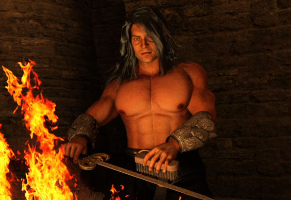

  • dHandledHandle Posts: 617
    edited July 2015
    tl155180 said:
    So my question is - Is it possible to light a room well with just one light source in Iray (like you can in real life), or do we still have to use multiple sources like we did with 3Delight?
    It's possible, but the result will be very harsh and unflattering, although it will be realistic. Portrait lighting to make people look good involves a key light, back light and rim light. One bulb in a ceiling light will look like a Nazi SS interrogation!
    But, if that's the look you're going for, it should be doable.. The side of your model opposite the light will be very dark. If you change tone mapping settings to get that part of the scene brightened up, the rest of the room will look blown out with light, and very unnatural.

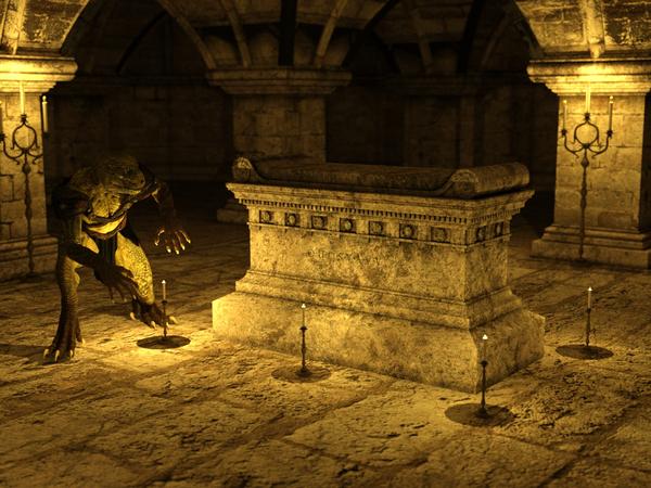

    Here's a quick test render I did with conditions similar to what you mentioned.
    Scene only
    Tone mapping settings:
    ISO: 400
    Shutter speed: 1/60
    Aperture: 2.0
    Emission settings: 200 W (Watts)
    Temperature: 2900
    The room was probably a poor choice...too dark. I put Iray base on just about everything in the scene. Including the skin. *gag* Skin looks terrible...needs a lot of work...
    1280 x 720 - 383K
    Post edited by dHandle on

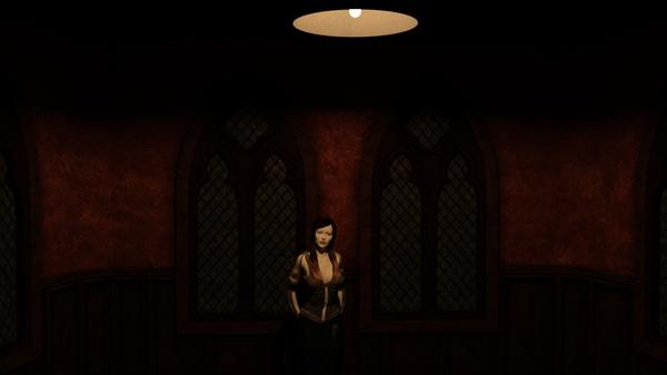

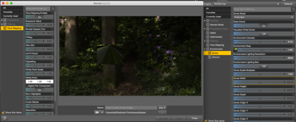

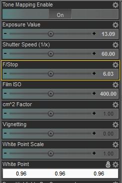

  • tl155180tl155180 Posts: 994
    edited July 2015

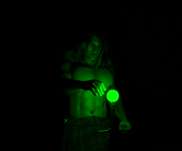

    I just woke up (its morning for me now) - thanks to everyone for your helpful comments overnight.
    It seems to me that although Iray is physics based and a big improvement in terms of lighting (for me) it still seems to rely quite heavily on direct light, with areas lit by indirect light being too dark by comparison to reality. So I keep feeling like I need additional lights in every indoor scene just to cheat and even up the direct vs indirect lit areas. I had hoped that we'd left that aspect behind when we moved from 3Delight to Iray and it seems that Iray has improved it somewhat, but I think its still a long way from realistic.
    For instance, I was lying awake in my room last night, pitch black except for the light from my bedside lamp, and holding up my arm to the light. Obviously the side that faced the light was well lit, but the side that didn't face it was also reasonably well lit so that I could still see all the details on my skin etc. It seems that Iray, or maybe PBR in general(?), still cannot achieve this without cheating.
    Below is an example image to illustrate. The light in the middle of the room is quite bright and the walls are all light and smooth, but the indirect lighting on her back is far too dark, in my opinion, in relation to the amount of light in the room. I was wondering if theres any way to increase the light on her back without actually adding another light to the scene or making the center light blinding?
    Thats just a basic lamp with Iray emissive shader applied to the glass surface.
    Tone mapping:
    EV: 12
    SS: 16
    F/stop: 8
    ISO: 400
    1000 x 1000 - 733K
    Post edited by tl155180 on

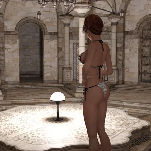

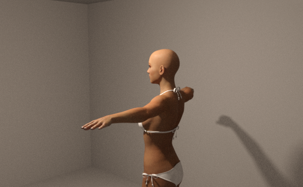

  • BejaymacBejaymac Posts: 1,978
    Attached pic is a quick render, one point light set about 1 meter in front and above her, she is about 2 meters from the side of a ten meter cube, Iray default settings and set to scene only, the point light is set to 25K Lumen and 100K temp.
    Her shadow on the cube is quite light in color, and the parts of her in shadow are not jet black, this is due to light bounce, the light is strong enough to have reached other sides of the cube and is now being reflected back as "fill" lighting.
    Point lights normally work best for this as they cast light in virtually every direction, only draw back is all of that light bouncing around needs to be calculated by the engine, which cranks up the render time.
    432 x 623 - 133K

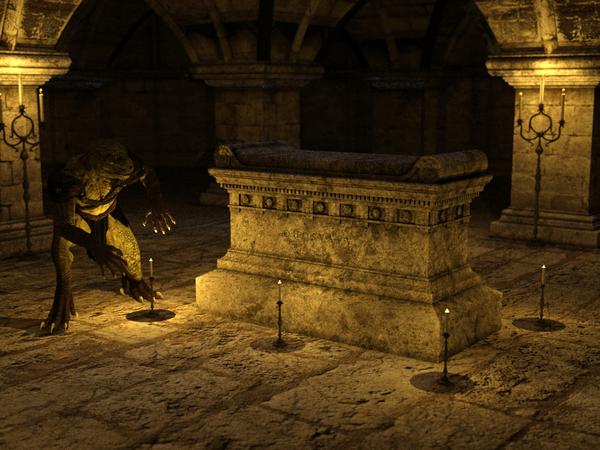

    What would be really useful is if the "Environment Intensity" slider under Scene Only environment settings actually did something indoors. I'm wondering why thats there at all for scene only? Has anyone been able to get it to do anything?
    Edit: This is closer to what I'd expect the light in that room to look like, but to achieve this I had to add a softbox behind the figure using a spotlight. Thats all well and good but it adds incorrect shadows and reflects very obvious light onto areas like the lamp stand.
    This is a case where upping the environment intensity would be a simple and easy fix. Its a shame it doesn't work.
    1000 x 1000 - 747K

    What I thought I understood was that Environment Intensity is delivered outdoors by the Iray dome. Therefore, if you have a completely sealed room and use Scene Only mode I don't see how it does anything.

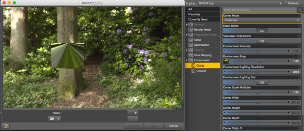

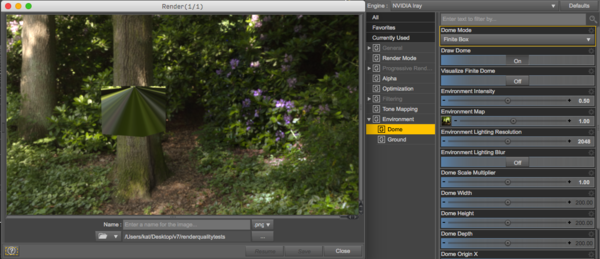

  • vex3dvex3d Posts: 130
    edited July 2015
    You need an environment map loaded in for the env. intensity to work.
    Also loading an environment map will help with the 'too dark' corners in a single light room.
    I would say you are missing your environment, and your actual props aren't bouncing light properly to get the 'backside' of things lit the way you want.
    And as pointed out earlier in thread - photographers have to 'cheat' to get their lighting right... We do too! Don't be afraid to position things off screen to get your vision a reality.
    Some things are about the journey, and some things are about the destination. In this case, its the destination. You've got an idea of how you want it to look, so worry about the final appearance instead of what it took to get it. Ever watch mythbusters? They first figure out if its 'realistic' or not, and then they see how far they gotta go before it IS real... ( you know, explosions and hollywood stunts etc! )
    Post edited by vex3d on
    edited July 2015
    So..that would mean it's primary use is in outdoor renders?
    As I understand it for this project, there is supposed to be no light coming in from outside the room. It's either dark outside, or a completely enclosed room with no light coming in from doors or windows.
    Makes for interesting work-arounds!
    edited July 2015
    you set the environment map ( env mode should have 'dome' in it if you want to use the dome ), and then you pick dome mode. your options are as follows:
    infinite sphere ( w/ or w/o ground ) ( outdoor / sky scenes )
    finite sphere ( w/ or w/o ground ) ( havent played w/ it yet .. can't tell you anything about this one )
    finite box ( w/ or w/o ground ) ( perfect for indoor scenes )
    you can load an 'indoor' environment map ( that has no light sources in it, just colors or bounce ... even a gray blurred image will give you a good amount of 'fake bounced light' and then you play with the intensity from there.
    and I just want to say unless you are completely SEALED in ( where even oxygen can't come in ), you should have residual light from SOMEWHERE even indoors. I think the only place you can find real 'pitch black' is in an actual CAVE underground. ( now that is some black black darkness ) Perhaps a moonless night in the middle of the sahara desert too... but I can't vouch for that because I've only been in an underground cave ;)
    edited July 2015
    Thanks for the tips. Yeah its slowly dawning on me that I'll have no choice but to cheat. Its a bit depressing, because I thought Iray was going to mean that wasn't necessary anymore. But hey-ho!
    Are we all talking about the same feature when we say "Environment Intensity"? Because the setting I'm talking about (located in the Environment section of Render Settings) doesn't need an environment map to work. It'll work fine with or without the map in "Dome and Scene" "Dome Only" and "Sun-Sky" modes only. It works either outdoors, or indoors if theres a break in the room 'box' somewhere.
    But it doesn't work at all in "Scene Only" mode in my DS (unless I'm doing something very wrong) and theres no environment map option there either. And if you've set your scene in a closed room with no windows it does not impact upon the scene at all no matter what environment mode you choose.
    If this isn't correct could someone please illuminate me (pardon the pun) as to where I'm going wrong? I'd be very interested to see a screenshot of an indoor scene where there are no windows and environment intensity is the only light showing.
    * Note I'm not talking about HDRIs here. I'm talking solid geometry indoor sets. Basically a solid cube primitive around your character.
  • DekeDeke Posts: 1,636
    I'm also learning the ins and outs of domes and enviro maps. Do enviro maps work on interiors? I just thought they acted as a dome (a sky) for exterior shots.
    The way I understood it was that you can load an HDRI into the environment map when the dome is switched on and that can give you your "set", if you like. So the HDRI can be either an outdoor scene or an indoor scene. With this method environment intensity will absolutely work fine because the intensity is coming from the dome and its the dome you loaded the HDRI into.
    However, if you use a solid box primitive set like I am, you can't even see the Iray dome because its blocked by the set, so environment intensity will not penetrate it either. Its the exact same reason why skydomes don't work anymore.
    That was my understanding and its what I've always encountered when rendering.
    Although I'm beginning to wonder now if my DS might not be working right and I need to submit a support ticket...
    Doing some tests right now so I can provide some more experience.
    I have 6 hi rez squares w/ iray shaders on them ( stucco and wood ) and a single candle light attached. Scene only lights, no env. map. Will post my results when they are done ;)
    I was about to comment on that...to properly 'bounce' an item needs to have a surface that Iray will 'see' as a proper Iray material. So it needs at the minimum, the Iray Uber.

  • KhoryKhory Posts: 3,854
    tl155180, something you may not be taking into account is the volume of space that would realistically be lit well by a single light. The larger the space the more the light decays between the source and the walls and then back again. By nature most "rooms" we use are larger than standard because of needing space for camera placement.
    I did a quickly with what amounts to a hundred watt bulb in a 16x16 room. I guesstimated the room height so it is about 10 foot which is a bit high for a modern room. Walls are .54/.54/.54 (light gray) and I set the tone mapping to a 400 iso fstop 3.
    600 x 371 - 295K
    Mode set to Dome and Scene. Set to Finite Sphere. Draw Dome On. Visualize Finite Dome on. Enviro Intensity at 1. And the stock Ruins 500 HDR loaded. and still no sky out the window.
    Are all "sky domes" in Iray these invisible HDRI's?
    Hi dkutzera - I think you posted in the wrong thread by accident, but I know what you're talking about so its ok :)
    The Ruins 500 HDR is for lighting only - its not meant for image. Thats why you're getting a blurred image on the dome. Remove it from the environment map and you should see blue sky instead.
