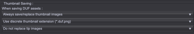

  • TotteTotte Posts: 15,110
    Hmm, ok, needs to take a look then. I guess it might have to do with the thumbs settings, guessing, haven't tested yet. You can now in DS set how and when DS should or should not create thumbs, I guess DS creates thing.duf.png. Thumbs can be thing.duf.png or thing.png, and if you have both, thing.duf.png is shown.
    We'll soon know though.

  • barbultbarbult Posts: 27,500
    These are my thumbnail options in Preferences.
    769 x 132 - 24K

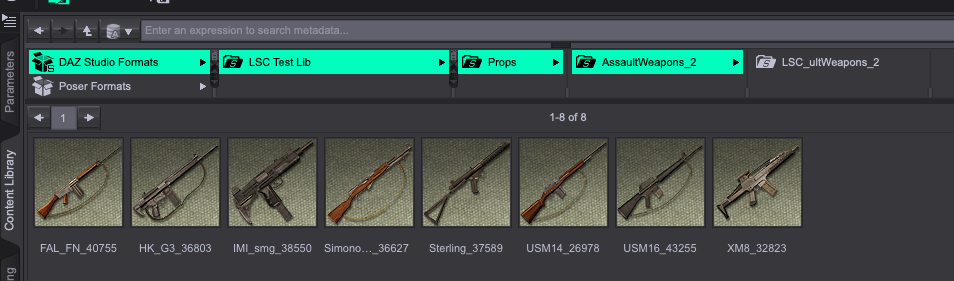

    ok, to say something very unhelpful, works here, but might be something different between macOS and Windows then.
    Thumbs settings:
    Result  from a Poser Character folder:
    439 x 527 - 88K

    Are those .duf.png images you list, the original poser thumbnail images, or ones created in the process of conversion? In my case, the converter did not copy the original thumbnails, it created new ones, with items loaded out of frame, and looking messy.
    Post edited by barbult on
    OK, checking, they are created, will check why it failed to copy the original. I think it does, maybe DS overwrites them after.
    From my debug-log:
    2025-02-17 22:47:53.737 [INFO] :: Saved image: /Volumes/StudExtra/LSC Test Lib/Props/AssaultWeapons_4/Tavor_24301.tip.png
    2025-02-17 22:47:53.830 [DEBUG] :: Saved:/Volumes/StudExtra/LSC Test Lib/Props/AssaultWeapons_4/Tavor_24301.duf
    2025-02-17 22:47:53.830 [DEBUG] :: transferThumb(/Volumes/StudExtra/LSC Test Lib/Props/AssaultWeapons_4/Tavor_24301.duf) called
    2025-02-17 22:47:53.832 [DEBUG] :: sNewThumbName=Tavor_24301.png
    2025-02-17 22:47:53.833 [DEBUG] :: Set thumb to:/Volumes/StudExtra/LSC Test Lib/Props/AssaultWeapons_4/Tavor_24301.png
    edited February 2025
    Is Tavor_24301 the name of the original prop, such that a copied thumbnail would even match by name? In my case, the name of the converted prop did NOT match the name of the original Poser prop, so even if the original image had been copied to the folder, it would not have shown up in the Content Library. You can see that name mismatch in the screenshots I attached earlier. Or are you renaming the copied thumb image to match the new prop name after copying?  I can't interpret the log file well enough to tell.
    The thumb name is converted, but it failed to copy it when DS saved one generating the prop.

    And it works again!
    954 x 281 - 111K
    Post edited by Totte on
    Update submitted
