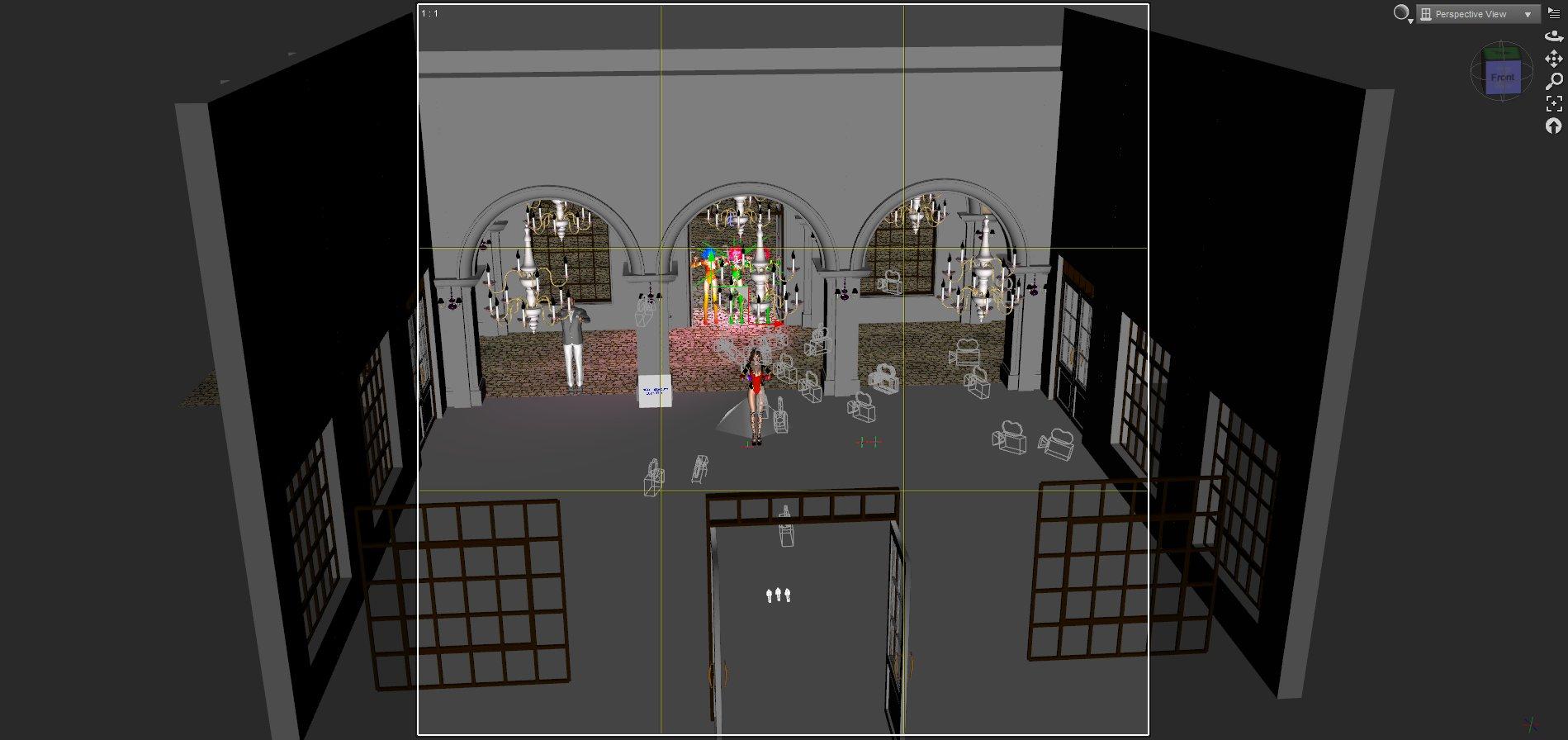

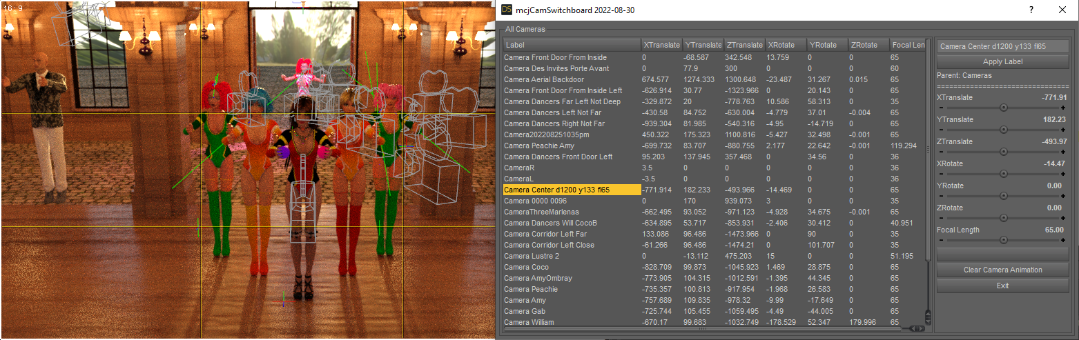

You click on a camera in the list of all cameras in the scene
or cursor up and down that list
and the 3D-Viewport camera changes to that camera.
then you can tweak (Local) Position / Rotation and The Focal length of the selected camera  using the sliders
... without exiting the script, so you can continue working on your other cameras immediately
plus a Clear Camera Animation button, so that "static" cameras are static
the current frame values are then keframed at frame 0
the parent node of the selected camera is displayed on-screen so you can figure why your static cameras are moving
and you can re-label the cameras, so the labels are meaningful.
it helped me for this scene where cameras had names like Camera 4 (2)
It Shall be released within 3 hours, maybe 15 minutes you never know :)

     'tis ready and online
    https://sites.google.com/site/mcasualsdazscripts10/mcjcamswitchboard
    didnt close Daz Studio and re-try the script, so there's a tiny chance ...
    ok I try it
    save scene
    close D|S
    re-open scene
    try script
    yes works fine ( so I didn't leave undeclared variables behind )

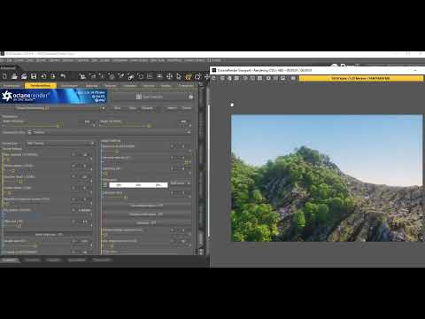

    Works great with Octane since you already have a rendering viewport. Camera thumbnails would be a great addition also.
  • TugpsxTugpsx Posts: 921
    Did a quick review over at YouTube
