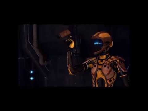

  • With some patience & understanding, I believe DAZ is a great tool for animation. These clips were made exclusively with DAZ! Keep the faith! DAZ is only going to get stronger!
    For more check out my youtube y'all :)
    https://www.youtube.com/user/SoftCelAnimation/videos
