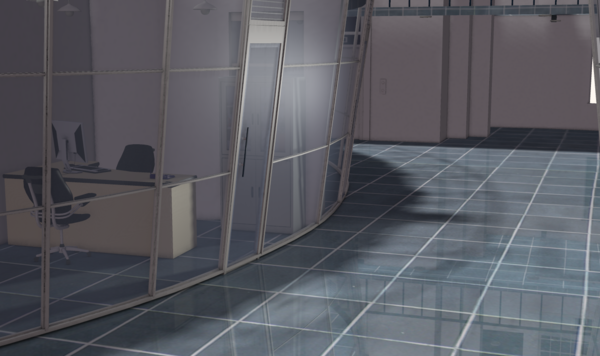

    You do not need a reflection map to make a floor reflective, as long as there is something else in the scene for it show reflected. Just click on the appropriate material, go to the material room and set reflection to ray trace and ensure the reflection value is not 0. Below is what I rendered of the SpyLab 3 from Poser's own content after setting the floor reflective.
    1387 x 822 - 971K
