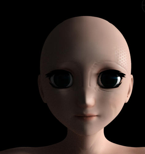

robo geisha in Iray?
IppotamusIppotamus Posts: 1,580
I have been trying to get http://www.daz3d.com/robo-geisha-for-hitomi to work in Iray.
I'm not worried about the glow, as much as I'm trying to get the robo lines, like in this image: http://www.daz3d.com/gallery/#images/62288/
They are very clear and sharp, while in the Iray you can barely see them at all.
I tried increasing the Render Sub Divisions in the mesh, but that didn't really do anything at all.
It may be a tall order, I know MAB and WillDupre did some crazy mat work on robo geisha.
But if anybody else has this product and got it working, I would be really interested in how.
Thanks for your time and thoughts. :)

  • Digital Lite DesignDigital Lite Design Posts: 728
    I own this one. I will play with it and see what I get. :)
    The seams are done with Displacement, which is the problem.
    In 3Delight, any object with displacement is automatically subdivided on a massive scale, so the displacement looks good no matter how dense or sparse the object mesh actually is.
    In Iray, subdividing is explicitly set to a value — you can change this value, but if part of the object mesh isn't as dense as you need for the displacement to work, the only thing you can do is bump the value up a bit more... until D|S crashes, which happened to me a couple of times when I tried it. Not even the usual SubD value for HD morphs (3 or 4, I think) is enough for something as finely detailed as those seam displacements.

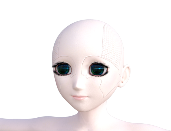

    edited July 2015
    I was able to get it to work by applying the Iray Uber Shader base to the figure, and I converted the Displacement map to a Normal Map. Remove the Displacement map then use the Normal map instead, and you should get this with no SubD changes at all:
    Keep in mind, I have only converted the face so you can see the difference. :)
    1300 x 1000 - 692K
    Post edited by Digital Lite Design on

    P.S. I used Shader Map to quickly convert the map. It is fast, easy and inexpensive. It also allows for a demo before you buy.
    Iray plays MUCH better with Normal Maps, so it is a good idea to add a tool to your workflow that will allow you to create normal maps when you can. :) You will not have to set the render SubD so high for things like this, thus rendering faster and with more stability.

  • IppotamusIppotamus Posts: 1,580
    This looks just great!
    Thanks so much for diving in there.
