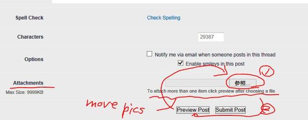

    Hi,, to attach pic, you have attachment section, when you reply, just click button, and upload your screen shot
    or render image from your PC.
    It may help lot to reply what can do to remove your problem.(and what is easy for your case)

    I was using "Fast Reply" which doesn't offer attachments (maybe that slows you down? ;)
    Thanks for the tip, kitakoredaz

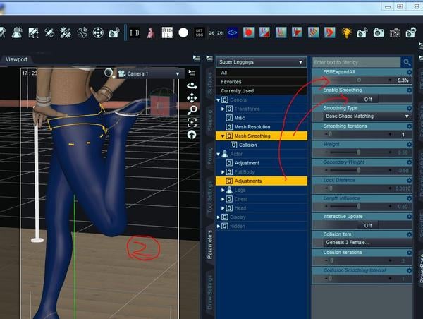

    Hi,, I am not smoothing modifier master,, but can offer some substitute.
    1. You may try bake smoothing modifier with zero pose first, then use it as moprh.
    after that it not circulate and try to collision item .
    though it may not work perfect, when you pozing, but it can reduce poke through.
    2 try to adjust smoothing modifier hidden property as pendaria suggested already,,
    though,,, I can not manage it well .
    (I feel pendaria know smoothing modifier well :)
    3 OFF smoothing modifier, but use push modifier then color push modifier weight which I need only apply.
    , or simply use moprh which included in the product.
    most pantyhorse should include expand all etc. then adjust thickness without collision.
    in my pic I use most simple way^^; use expand all. then OFF smoothing modifier.
    but I will need to adjust the shoes too.

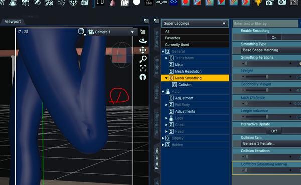

    4 it is more tricky,,
    but I sometimes plan to make bodysuit which cut somearea from exported geometry shell.
    or use product and modify it.
    then cut some mesh by 3d modelor or geometry tool,
    where I do not hope to apply smooth modifier.
    eg about your case, I may cut under the knee part poligons.
    and set the bodysuti as hidden. or full opacity.
    (it is unvisible body suit , which cover actor body part, but only for use
    smoothing modifier collision target)
    apply smoothing modifier for the panty horse, but set collision item " as " invisible bodysuit"
    then smoothing modifier only count over the knee . I believe it should work.
