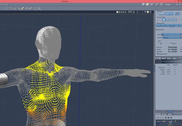

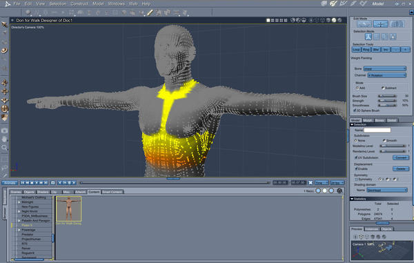

    I loaded Don into Carrara, Double clicked the "Model" level in the Scene Instance list to edit the model in the Vertex modeller,. Switch to Animation mode,. click on the weight paint brush,.. and select a bone.
    You can see in the Pic, the area weighting already exists for the chest.
    Looks like nothing is stopping you repainting and saving to your browser.
    There was no mention of protected topology for Don at any stage in the editing / painting or saving to the browser ( My Objects)
    I think that bringing in the OBJ and then rigging and weighting it may be a better option than just repainting the already rigged and weighted poser figure,.
    But the end results may simply be the same as the original poser figure.

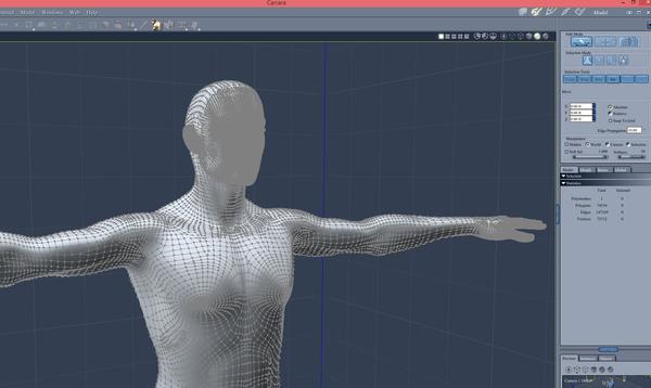

    What 3DAge has said is accurate (no surprise there). However, you can edit the weights of the various bones on the earlier figures (Michael 3 for example).
    OK, so if you load a generation 3 figure like Michael 3 (see pic below), and select the "model" level in the instances tray and then enter the vertex modeling room, you will see the figure mesh. In the upper right of the properties tray, click the middle icon for the animation mode in the edit menu (looks like a human torso with the arms spread). From the top menu, select the paint brus looking thing to edit the weights of influence for each bone. Use the menu on the right in the middle to select the bone you want to edit the weights for.
    Note - from the Poser9verse, this not identical as the weightmaps for Rex, Roxy, Miki4, etc. However, yes you can customize the bone weights for V4, M4, V3, M3, etc.
    There is more on using generation 3 and similar figures at the following thread, including making morphs for bent joints in animation mode.
    http://www.daz3d.com/forums/discussion/58249/
    1439 x 999 - 202K
    1637 x 976 - 185K
    1457 x 979 - 138K

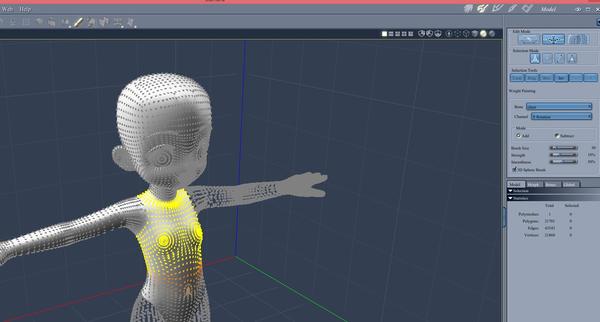

    And I just confirmed that the bone weight brush works on Near Me.
    1466 x 786 - 123K
