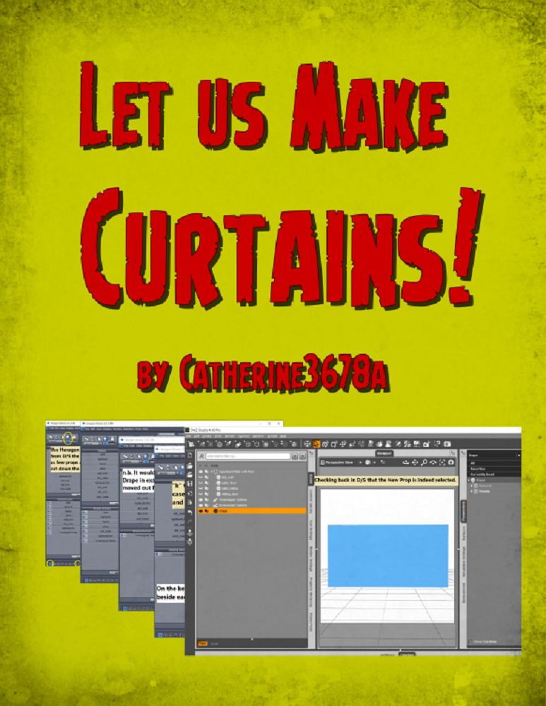

  • Visual tutorials tend to illustrate better how to do things in modeling I find. I like making tutorials and need something to do so I'll see if I can whip one up. It is truly an easy project and wonderful for a feeling of success :-)

  • I have a series of images made. I need to edit them and then paste them into a .pdf file so possibly sometime tomorrow it'll be uploaded to Renderosity. Takes a short while then for it to be made public.
    First project, one very basic drape aka shades ;-)

    You're welcome. The .pdf is in the proof reading basket, planning to upload it tomorrow [Friday] and usually within 24 to 48 hours products become available.
    The Cover :-)
