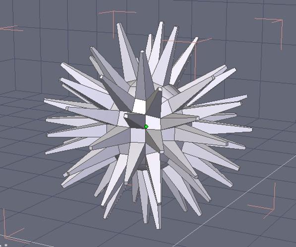

I'm basically trying to make a spiked ball or turn everyother 4-sided face into a pyramid, but I'm having trouble making each one the same size.
Do you know of any tips or tutorials that may explain this?
The easy ones I can answer :-)
Use the geodesic sphere based on a cube, lower the number of segments what you want. Then select the checker-board pattern manually - it can be done, but you need to be clever about it, otherwise you get adjoining faces.
Hit extrude surface, then be very patient while Hex thinks this out - otherwise it will freeze - it gives a funny sort of leap when its ready.
Then very carefully manoeuvre the mouse till you get what you want.
Great I will give it a try!
