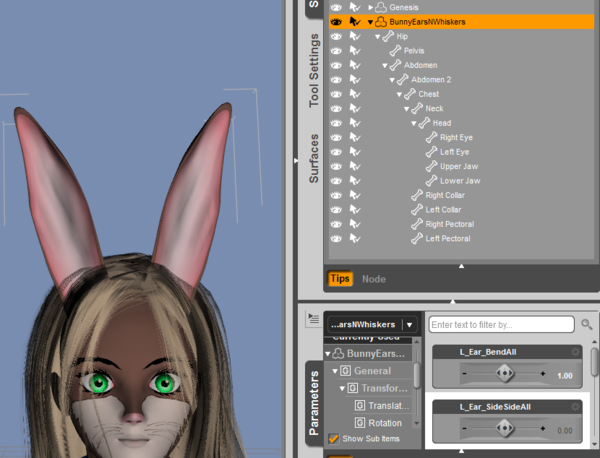

I thought I would start the progress of shifting my characters to genesis, since I bought the shape packs and have every old gen 3 texture converted over to gen 4, and genesis (1) can use the gen 4 maps. Anyhow, I was quite encouraged by the results and even thought about changing him over to the policeman for genesis until I discovered that the a3 ears no longer have the easy pose. I try to spin the dials and nothing happens. It's just a prop on his head, there isnt any ear joints or anything. I tried parenting it, the whole 9 yards. it just isnt there. Dont get me wrong, they look fantastic without any extra work but they just won't bend or twist, see the attached snapshot. Each ear should have about 8 extra joints to allow for complete bending and movement

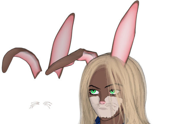

After trying twice I still cannot easy pose, nor do they bend as easy as they used to. I even tried to overlap the source and the autofit in the hopes that the weightmapping would work well but it doesnt.
I dont think Genesis Alex is amused by his crinkled ear. :P

I think I'll just stick to the parenting for now. that was bone 6 that I bent, along with bone 5, the other bones warped the mesh too badly.
