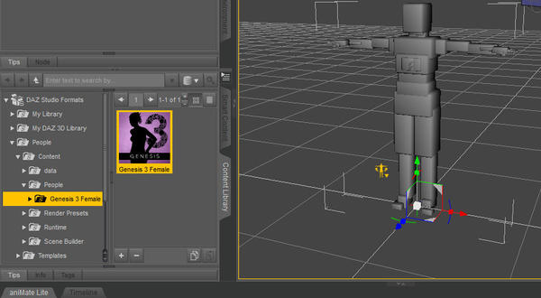

    Ok as install manager wont pick up gen 3 I had to install her manually so it could be she is in the wrong place have two screenshots of the error message and her location in my content pane

  • LeanaLeana Posts: 13,670
    edited July 2015
    Yes, she is in the wrong place.
    It seems like you have just unzipped the DIM file directly to your library folder, so there's an extra "content" folder at the top level (DIM installs whatever is in that "content" folder, that's why it's there, but you need to remove it when you install manually).
    Take everything in the "content" folder and move it up one level, so that for example "data" and "Runtime" are directly in the "People" library

  • jestmartjestmart Posts: 4,449
    You problem is when you installed manually you extracted the "Content" folder from the zip to your library, only extract the files and folders that are inside the "Content" folder. You now need to drag and drop everything in "Content" up one level.

    (and yes, this looks as if you have installed things in the wrong place. The manual installer has a top folder "content". You have to move the content out of there to install it properly)

    Thank you she is now where she should be and working for me
