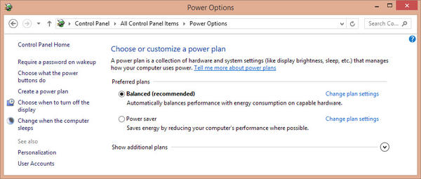

    While we on the subject heres some useful tips on using Window’s Resource Monitor.
    In Win8 (and I think Win7) you can open the Resource Monitor by opening the Task Manager (CTRL-Shift Esc), select the Performance tab, then click on Open Resource Monitor at the bottom. Select the Overview tab, and drag the window to the upper right of your display. (see pic)
    The CPU and Network graphs are the ones that I pay attention to.
    • The blue line in the CPU graph is your clock speed. If it’s pegged at 100% you’re probably running your PC too hot and you can easily drop its temperature and save money by going into Windows Control Panel-power options and playing with the settings in there. (2nd pic) What you’re looking for is a blue line that hovers around the middle or less while you’re not doing anything, but goes to 100% when you are. It’s adjusting your clock speed to give you the Max power when you need it.
    • The green line is your CPU consumption. When Carrara is rendering using all cores, it (and the blue line) will be pegged at 100%, but there are some Carrara processes that only use a single or a few cores like the preliminary stages in the Full Indirect Lighting. By simple observation you will get to know Carrara a lot better, and this is helpful.
    • If you’re running a personal render farm you’ll find the network graphs also very helpful. I personally cannot run LAN cable to all my PCs, 2 have to use Wi-Fi. If during network renders you notice that your Network graph has no empty “valleys”, your actually slowing down of your render farm performance by bottlenecking your network. You can modulate this by playing with the render TILE SIZE option in Carrara’s Rendering tab. With a minimum Tile Size of 16 my render farm chokes out my network. But by giving each render node a larger piece to compute each time you’ll notice more spaces appearing in your network graph, which is what you want. I found the value of 48 or 64 for tile size seems to work well for me. It all depends on how fast each render node’s computing its segments. Long slow renders can use a smaller tile size.
