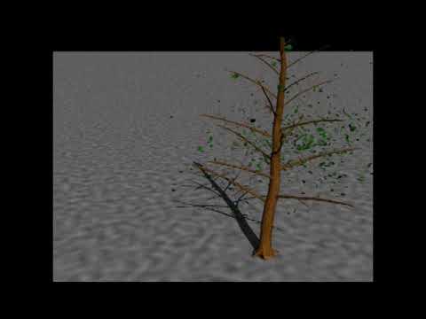

     I was able to make a crude quick test of 2 generations of branches growing and leaves growing in succession, with a little overlap. Your animation would need much more care and planning, but anyways, for lack of a better term this is a "stop motion" animation. smiley
    https://youtu.be/8zHYPfv-2ZA
    This is just the generic plant dropped in. I didn't animate the trunk. In the Experts Tab, I dialed back the Length Ratio in the Gen1 Branches, and udjusted their Start and End angles so as I increased the Length Ratio, they would grow up and fall down outwards and give a little bounce.
    I also changed the Leaf Size from 0 to 1 and gave them a slight Twist.
    So, with each change I made a render and gave them names to be used as an image sequence and then rendered out a final movie.
