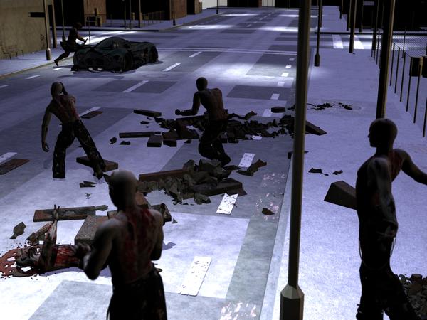

    I don't use Iray so can't help you there but to set the DoF on the cameras in Studio you have to match the focal point and the F/stop to the focal length of the lens to get the area you want sharp whether it is all the scene or only a face with the rest out of focus.
    On this image the near DoF plane is just in front of the two nearest figures so they are out of focus and the far DoF plane is on the other side of the car so everything after that is out of focus. The sharp area is between them starting at the lying man and past the car. The lens focal point was on the car and I had to adjust the F stop and move the focal point back and forwards until I had them where I wanted them.
    1280 x 960 - 819K
  • tl155180tl155180 Posts: 994
    Yeah, this is my point. Theres already an F/stop function included on the DS cameras, so I'm wondering why there needs to be an F/stop setting in the Iray tone mappings as well. It seems to serve no additional function other than to adjust light levels. Perhaps its just a feature of Iray that Nvidia included but it was made redundant by the existing feature in DS.
