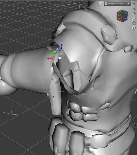

    Hello,
    Here is the result after moving the arm. (Img01)
    Regarding the videos, I do not understand English. I just tried with the images but it is not conclusive ...

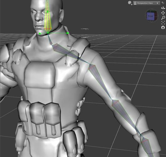

    I tried with a character in one block (no separate members ...). I put the bones (img02). There is good I understood the process ...

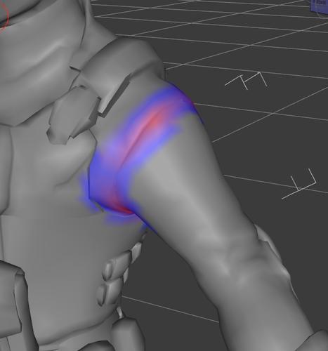

    Then I applied the brush from Brush Map Node Weight / Weight Editing / Fill Bones By Selection Group (s) (Img03).
    But when I move the arm, only the bones move.
    I think in this case I'm missing a step ...
