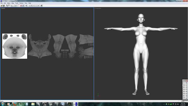

Has anyone else found this to be odd.
1. Create a new Victoria 7.
2. Export her from DS as an .obj.
3. Open UV Mapper Pro or any other OBJ manipulator. Load in your Victoria 7.obj
4. You will notice that the face is the only map that is within range, all of the others are out of range.
I find this particularly interesting because the models render properly but according to the templates the polygon are located outside of range. Can anyone shed some light on this for me? I'd love to build my own textures for V7 if I could but I'm not sure how to get around this issue. Any help is greatly appreciated.

    Gen3 uses the UDIM method of laying out UVs.
    http://bneall.blogspot.com/p/udim-guide.html

    Like Vaskania said, the UDIM is a new method of doing the UVs...and if the tools used don't support UDIM, out of range is what you will get.

    OBJ Export -> Check "Collapse UV tiles" will put them all on the same tile, like "traditional" UVs.

    It doesn't affect the mesh at all - it just affects how the mesh's vertices map to UV coordinates.
    With "traditional" UVs, UV coordinates must be between 0 and 1. So if you want to apply multiple image maps to the same object, you have to stack the UVs. UDIM lets you use coordinates outside of that range, so that you can keep UVs from overlapping.
    For example, the filename for V7's face map ends in 1001. This tells DAZ that the UV coordinates for that map will lie between [0, 1] in the U direction and [0, 1] in the V direction.
    V7's torso map ends with 1002. This tells DAZ that the coordinates will be in [1, 2] in the U direction and [0, 1] in the V direction. Legs end in 1003, which means it maps to [2, 3] in the U direction, etc.
    So the application needs to "understand" the relationship between filenames and UV coordinates, or else it will consider U and V values greater than 1 to be out of range. In that case, you need to stack all of the UVs onto the same tile - i.e., subtract 1 from the U coordinates for UVs in the 1002 tile, subtract 2 from the UVs in the 1003 tile, etc.

    My understanding of UDIM in this case is that it is just like any of the other UV sets. Meaning no special magic to make it work.
    It's another way of laying out your UV islands if you will. Maybe even considered alternate UV coordinates?
    It's not specific or only for G3F - you can make UDIM compatible UVs for the G2 figures as well.
    Not every program supports UDIM and for those that don't the "Collapse UV Tiles" should be used.
    I've had no issues with the new figures exported with and without this option checked. :)

    Now I know it's been mentioned.
    Collapse UV maps, on export from daz. Helps other apps work with the maps.
    Now when you go to put them back into studio? Is the UV mapping of the 'Collapsed' maps altered so much that they will not work on G3F's UDIM mapping in Daz Studio (especially on an unaltered G3F UV/UDIM)?
