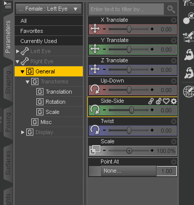

Go the other way around...expand V7 in the scene tab and select the eyes, then point them at the null or camera.

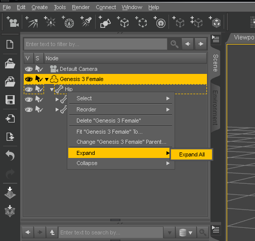

1. Scene > click to select > right click > expand all

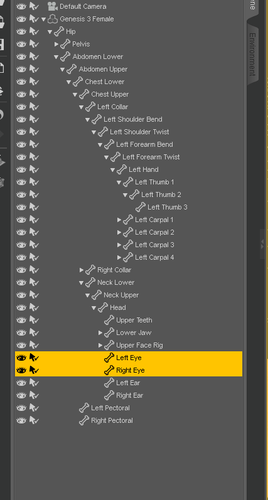

2. drill down (I collapsed some sections to get it all to fit) to find the eye.

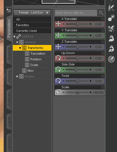

3. Eye in Parameters...make sure you are on General and not Translations or Currently Used.
Thank you so much! That worked! Denise
