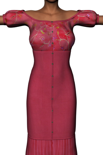

I did a little test to get V4 clothing on G3F.
I tried with a couple of items and it seem to work.
It might require 'Victoria 4 for Genesis 2 Female', can't remember if auto fit V4 to G2F is standard.
Requires: G2F and G2F

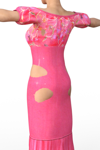

    edited October 2015
    I've noticed that sometimes you get a small amount of pokethru that collision doesn't work for which I just add a push modifier at .1 to fix. Also with some leg poses there is a bit of mesh distortion that look like they need jcm's for the clothing. I haven't looked to see if Gen3 has jcm's for those poses but if they do it might be that the morphs need copying to the clothing. I'm assuming this is for your own use and not for distribution. To be honest I haven't used Gen 3 much as so far I haven't bought many things for her. I love the base character but so far haven't been impressed with the characters or the hair on offer so far. I did buy the teen figure and skyler though.
    I just tried transfering the jcm's with the transfer utility but that doesn't fix the problem with the mesh distortion. I think that would maybe require so weight map editing.
    600 x 848 - 697K
    Post edited by Pendraia on
