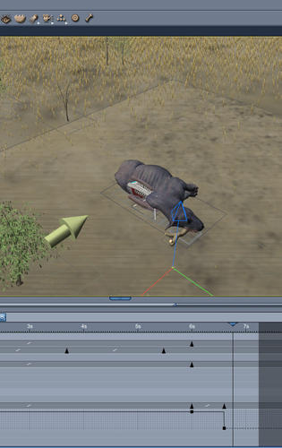

I am busy with a CSI scene of a poached rhino (based on a real scene I visited here in South Africa) for a major news network.
I used the hair tool to create the long grass, which works well as you can see. My plan is to make it invisible over about 1 second to make the scene look more stylized (and a grid shader to replace the soil shader.
But, to make the hair vanish is more of a mission than I anticipated: As you will see in the sequencer, it is supposed to be gone after its visibility has turned to 0.
Can this effect only be obtained by making the hair shader invisible?
Side note: I find it rather frustrating that the visibility parameter for objects cannot be animated with spline tangents, i.e. make it to fade aeay over time.
Can anybody help please?

    Yes,. you'd animate the hair shader
    Carrara doesn't have any way to animate object visibility over time (Fade in / Fade out),. it's an on/off thing Visible or invisible on a single key-frame.
    By animating the shader transparency, you can "fade" the visibility of the object.
    However,...
    The Hair shaderr doesn't have a Transparency option.....
    What it does have,.. is Density / Length / and Thickness.
    A quick test with a sphere would suggest that the Thickness , or Length is your best options for animating the disappearance of the grass.

    It's very easy to do a grass texture.
    Why not use a multichannel texture and tweek the alpha channel which can be animated ?

    Actually,. I think DUDU's idea is simpler,. easier.
    Just change the shader on the grass, to a normal Multichannel shader, ..rather than the "Hair shader"
    That'll give you the options for Alpha value,. or Transparency Value, which can be easily key-framed.

    I thought it HAD to be a hair shader to work on hair,( the exception being in Octane where I can actually use any Octane shader but not instead rather applied in the viewport or the option in effects)
    Any attempt to change a hair shader to multichannel, terrain etc usually gives me black hair.

    Changing the Hair shader to a Multichannel, ..to get the Alpha or transparency options,... won't work.
    Cobusp will need to try animating the thickness or length,. to fade it in Carrara,.
    or do it in Post,. which is probably the easiest option.

    I return my medal to you Andy, I believed to have done it… Thikness is the best solution.
