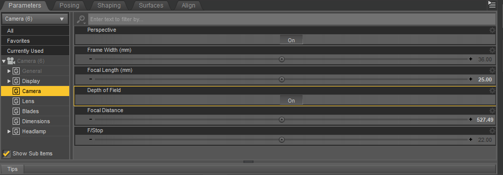

    I have that set and checked it out. It appears that some of the cameras that are included with the environment have Depth of Field on.
    The quick fix is to select the camera in the scene tab, then go to Parameters, click "Camera" then toggle the Depth of Field to off.
    If you want to keep the depth of field so the subjects "pop" a bit more, then you would either need to position them at the focal point or play around with the Focal Distance and F/stop settings to adjust the focal point.
    ETA: It appears that only Camera, Camera 2, and Camera 6 have the Depth of Field set to on. I also noticed that most of the cameras are set to a very wide angle (short focal length) compared to the Daz default.

    Thanks Chezjuan!  I haven’t used depth of field and never considered that Tesla3D would set the content up with it on for some cameras and off for others!
    I had previously tried adding a new camera when I was trouble shooting, and I just did this again.  Bizarrely, when you create a new camera for this set it defaults to “on” for the depth of field.  Anyway, I know how to manage it now.
