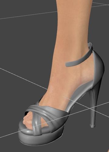

Hello,
I am very new to modeling and fitting items to DAZ Figures. I modeled highheels for Genesis 2 and follwed this way to transfer them to Gen2:
modeling around the pose foot --> importing mesh into DAZ --> put Genesis 2 into footpose --> bake joint rotation --> zero figure --> using transfer utility tool; and voila it worked:-) (I do not know if there is another way - made this after a tutorial from bobbie25)
Now I tried exactly the same way for Genesis 3 and after using bake joint rotation the footpose cvhanged and so my mesh dose not fit any longer.
I have added 2 pics where you can see the problem; first one is only footpose with shoe and the second one after using bake joint rotation.
So, how is it then possibly to fit the shoes to Gen3? Where is my mistake? :-)
Hope here are some people who already have experiences with that and can help me;-)
I would be very happy.
Hope I did it right with the attachments:-)
Untill, you apply bake joint rotation, check some jcm should work for genesis.
you can see it select genesis3, then go to parameter tab, show hidden properties.
then go to currently used.
it means when you apply poze, or manually rotate, some node JCM auto work to keep ideal shape.
but if you apply "bake rotation" it reset these auto applied JCM. then remove these JCM value.
Though I do not know detail of your work folow,,
(I usually use transfer rigging,, though it cause some problem too, but I adjust again finally)
because you may use current actor only for "transfer"
then after all , when you load new figure, then wear your shoes,
these morph should be re-applied, then I do not think it cause problem.
then if you just hope to check, or you need to return the shape of gen3female,
you simply add these hidden parameter value manually.
(though it usually link with each node rotation, and should be auto-applied,
but you hope to see it, or hope to use the shape, you need to apply them manually for the
change rigging gen3female ( you may only use for transfer utility I know)
after all, I think , if you model high heel for pozing figure, you may need some tweak,
after "fit to" . (usually after fit to,, with best poze,,
make morph again for shoes, then return zero poze,, up-date geometry is my work flow,,)
Then,, I feel you may need to re-shape the shoes mesh.
because, I think,,
you modeled your shoes for pozing actor shape , then jcm deform are included the Actor shape already.
(I thnk you modeled shoes with template (gen3female pozing shape.obj)
but when your shoes fit to the Actor,, your actor will poze (for high heel)
next JCM work for Actor. then the JCM deform should be auto transfered (auto-follow) your shoes too.
it means current shoes re- applied the JCM deform value.
if I were you , anyway,, I try current shoes (after transfer weight etc)
fit- to actor, then poze actor. you may find some problem (not so hard,,)
you just make morph with reverse option for the shoes.with current pozing keep fit to actor.
then un-fit shoes, zero poes shoes. (edit, you need to remain the orignal morph value, to change base geometry)
and export the morphed sahpe as new zero shape of shoes.
improt again, then overwite geometry from top menu. Edit>figure>goemtry>update base geometry.
it should work.. (I do not expect to make shoes shape perfectly same as when it fit to pzing actor.
then tweaking mesh is easy,, after fit to,, poze actor, and modify it by morph , change base geometry)

Hi,, Kyrta, Ok, It should be long to tell all, but I try.
To model perfect high -heel shoes for DAZ genesis figures, (About your case Genesis2female. )
there are two plans
Plan 1. make perfect shoes shape for genesis2female zero pose. (it is not foot poze applied still).
and when gen2female poze for high-heel. (high heel pose, foot poze etc)
adjust deformed shape of high-heel, by re-tweaki weight-map , , applied morphs for foot rigs etc,,
Plan 2 just concentrate to keep good shape, when genesis2femlae poze for high -heel.
not care much about zero poze. you need not keep good shape for non foot poze.
(because, if we use high-heel,, we should bend foot .
that means, shoes not fit our zero poze shape. we change our foot poze for the high-heel or boots etc,,
then if we do not keep the foot poze,, shoes shape may break some how)
About your case,, you modeled your shoes for pozed shape. that means you choose plan 2.
but you seems miss one step (to remove auto-appleid joint controll morph from your model shape.)
now it can not fit well, after genesis2female pozing, as same as you modelied.
then try to correct it by most simple step.
please check again,,
A your shoes are fit to genesis2female, (non character morph)
B genesis2female are pozing (which you decided for high-heel) OK?
just keep it . but save curernt foot poze of genesis2female. (to set good poze easy)
(not tweak or remove auto-followed morph etc,, just keep it as same as when you use the shoes)
1. export current shoes (not fit well for pozing genesis2female) as shoes.obj to your favorite modeling tool.
you may need to export current genesis2 shape.obj (pozed) as template too.
2,correct the shoes.obj to fit the current genesis2shape, then export as morph.obj.
3 use morph loader pro , then import the morph.obj on to the shoes.
must check on, Reverse defomation Yes. see my pic1
4 now you have moprh controller to change the shoes shape better for pozing genesis2female.
you must see,, when you change the controller to 100% your shoes perfect fit to genesis2female.
you may better save the current scene, (if you mistake something,) see my pic2.
I hope, anyway you finisth these step. and you confirm, now your shoes fit well, when pozing,
with manually applied morph.
if all OK,
we can go next step ( combine deltta morph shape in base geometry of shoes
then you need not apply morph value whe ever you use the shoes.
I need to go job ,then can not wait you confrim ,then I assume you can confirm ^^;
if you have problem about how to use transfer utility etc,, I may reply after.
(I do not know the bobbie25 yout tube tutoriall for high heel,
but most step should same, though you seems use bake rotation, I used transfer rigging etc,,)
anyway,, shoes need to keep good shape, when it fit to actror pozing foot-poze.
but if actor keep zero pose,, shoes shape may break somehow, do not care it at current,,
though I re-tweak it if you need.
save current scene for protect your work,,
1 un-fit your shoes from current pozing actor.
2 apply zero poze (to poze default rig status ) for the shoes .
it may different how your shoes rigged. somecase your shoes rigs zero poze postion same as foot poze,
somecase your shoes rig with zero poze = genesis zero poze rig positon.
but it is not prioblem. after all, when your shoes fit to Actor, the rig controlled and deformed by Actor rig rotation.
3 export current shape again . (your shoes has been removed auto-followed shape.
but it only applied your import morph shape as 100% with zero poze)
eg newbaseshape.obj ( pic3)
4 to clear see, what happen, remove the import morph value to zero. (or use zero figure for the shoes)
5 now your shoes not keep good shape, but it is base geometry of the shoes. then you overwrite it by exported newbaseshape.obj
6 select the shoes (zero morph, zero poze) , then from top menu Edit>Figure>geometry>apdated base geometry (pic4)
7 select exported newbaseshape.obj . you may see, your shoes shape are overwritten.
8 save it as new figure. then wear the shoes on actor, and apply foot poze for actor,
now you should see, your shoes keep good shape whithout your import morph.(pic 5)
you may feel, you do not keep the morph anymore, then you can remove it if you need.
(I usually just leave it off,,, )
then,, I seems mistake to show pic with genesis2female not genesis3female,
(the only problem was auto-followed joint morph of genesis3female , but it makes no differende,
after you make shoes morph for the actor foot poze, and fit to it)
all step should work as same as genesis3female.

I followed the steps in your last post with the transfer tool:
it looks all ok as long as the shoe is not fit to a new Gen 3 figure; then it looks like the first picture shows.
I have no problem to fix the green marked area with weightmapping, deleting bones or with a corrections in my modelling program.
But I cannot find a way for the ankle strap; I know it is the JCM (I think).
I tried everything you mentioned here; when I make a morph the way you told me it seems to work (see 2. pic. ) but as soon as I save the shoe and try to fit it again to Gen3 the strap deforms again as you can see in the 3. pic.
I really do not know what to try anymore, maybe I should model ballerinas - they are flat ;-)
I could manage to fit the shoe to the foot so it look as it should, but only on the foot.
When I load the shoe without fitting to Genesis 3 the ankle straps and the backcap of the shoe looks deformed and I think they should have a proper looking also when loaded without a figure.
I do not have these problems with Genesis 2 with the same shoe (modeled for Gen 2 of course)

then pic2 , you set the morph 100%, then it should fit well (corrective),
but pic3 you not set the morph value (keep 0 %)
I think it is usuall . you need to set it manually 100%,
untill, you overwrite base geometry (include the moprh delta)
Ah,, :roll:I found one of reason, why the around sole mesh deformed when "fit to"
I test with product shoes of gen2female then export it as obj,
and modify it to fit gen3female.
about JCM influence, I feel the above way is right.
when the shoes fit to pozed figure, it auto follow JCM then fit well around ankle .
but I see deformed mesh around front sole as same as your pic.
Then I cneck again, when I bake rotation what happen with node visible.
it should not move any bones, but when I bake rotation,
all Toes of gen3female slightly move inward, then defrom mesh around foot Toes too.
it is not caused by removed JCM.
Though it is slightly move, but it should cause mesh deform about shoes,
after you transfer weight and rig from the "bake rotation gen3female".
