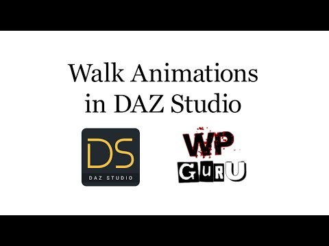

    One needs to expand the timeline to show the keyframes, etc.
    A couple of starter videos many found helpful:

    Catherine3678ab and Saxa -- SD thank you very much!  Both pieces of advise were very helpful and addressed my issue. I can now find the blasted things that were irritating me and correct them.  I had bought a "Compleate Guide" that was boarderline usless.  I have saved that Youtube vid and saved it in a DAZ help playlist that I have.  Again, thanks for the tips!  O7
