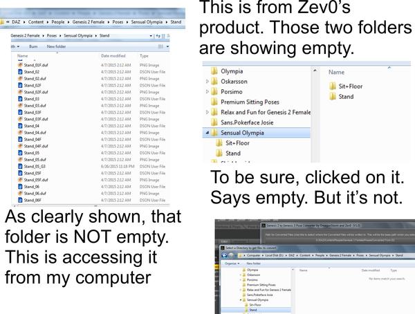

    Novica said:
    See screenshots attached to previous posts. The folders that Zev0's converter says are empty are not, and they are dufs. Each time I use the converter, the next time it will say that exact same folder is now empty. Did it with the eclypse folder too.
    I think they show as empty because you're probably not supposed to pick single files, as the button tells you to select a directory but not a file. It will add every pose inside to the conversion list. After that, just remove the poses you don't want to be converted, from the list, before you hit the convert button.
  • NovicaNovica Posts: 23,925
    I'll give that a shot. Thanks for the suggestion. :)

    Novica said:

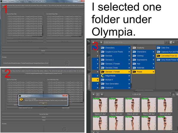

    Yes to all. Had done the same thing, and it worked. Then for the next pose (same product, aka the Olympia set) it said the folders were empty. I don't think one pose would be duf and the rest not. :roll:
    Edit: attaching screenshots I had made. NOTE THEY ARE DUFS AND NOT SHOWING UP!
    Your sceenshot shows that everything is working correctly. You are fixating on files but the converter works on folders. The screenshot shows the Windows file picker saying "No files match your search." because the picker is set to show only folders and there are no sub-folders in the folder you show. Just ignore that message and click the "Select Folder" button and the script will proceed to populate the list with all of the .duf files in the "empty" folder the same as if you went back up one level and selected the Stand folder before clicking the button. That message is informational not an error. Actually I'm not sure that you understand that the whole folder is converted at once. If you are selecting a file in the Script Interface that is really only for removing a file from the list and does not have any effect on what is processed when you click the Convert button.
    Tip: You can also select the Sensual Olympia folder and it will do all of the poses in that folder and the Stand and Sit+Floor folders. I went one further and selected /People/Genesis 2 Female/Poses and did all of my poses at once.
    Yep, I'm tooling right along and was getting ready to post that I was doing that. Thanks for explaining as it may help others. :)

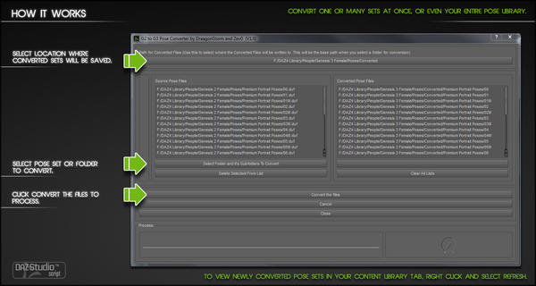

  • Zev0Zev0 Posts: 7,123
    Hi guys. Basically the way ours works is you create and choose the master directory you want all converted Poses to go. EG I called and linked mine to People\Genesis 3\Poses\Converted. Now all poses\sets you convert will maintain the same pose folder structure inside that. So for example if I select “Bluemoon Poses S6” from Genesis 2 that I wish to convert, it will create that same pose directory under the master I made which is People\Genesis 3\Poses\Converted\Bluemoon Poses S6. To get them to view in your content Library simply right click and hit refresh on your content Library tab. It will have Icons and everything. Just click and use. So now all my converted poses are not mixed up with the Genesis2 Pose files because I specified a path under Genesis3\Poses.
    1300 x 693 - 399K
