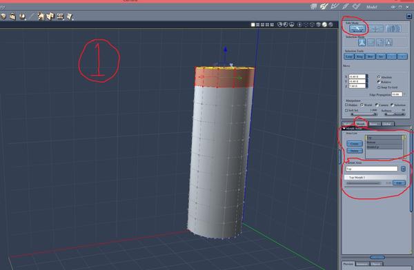

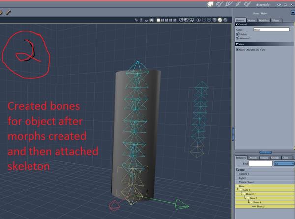

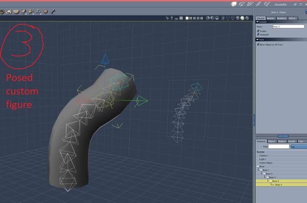

    I think there is more than one issue going on here. One is how to make morphs in general for a custom object. The other is how to make morphs for generation 3 figures. Here are some tips for making morphs in general for custom objects. We should be able to track down an existing thread for making Poser-style morphs for generation 3 figures, but don't forget that you can vertex model directly on the generation 3 underlying mesh in Carrara without creating a Poser-style morph. But here are some tips for making morphs for custom objects. At the end, I demonstrate morphing in the posed position for a custom cylinder figure.
    Warning - it will get longwinded but still leave stuff out. Hopefully, there is enough to help you get started exploring the tabs and menus you generally would use.
    Carrara's vertex modeler allows for (a) standard morphing, and for (b) morphing a rigged figure in the posed position.
    (a) standard morphing is just like what you would expect from your Poser experience. While modeling the object, save an altered version of the exact same object (same number of vertexes in the same order). Load that saved morphed version of the object and a slider will appear in the properties tray. Adjust the slider to activate the morph. In Carrara, in the vertex modeler, you first create a morph area, then a morph for that area. How? In the vertex modeling room of your object, in the properties tray (right side, top) the "edit mode" at the top should be in modeling mode (left of three icons, looks like a hexagon with an arrow). In the middle of the properties tray, there are 4 tabs for Model, Morph, Bones, and Global. Select "Morph." You will see "Area List" and a box with the words Create and Delete. You need to have a morph area created before you can actually establish a new morph. Existing morph areas, if any, will be listed in the box. If none exist, you could create one. Name your morph area if you create one. If any exist, highlight the area you are interested in, and a list of existing morphs will appear. It will also say "current area" with your highlighted selection in the box, with a tab for a drop down menu next to it. At this point, you can either use the drop down menu to create a new morph target, or you can click the edit tab next to existing morphs to alter one of those. If you use the drop down menu to start creating a new morph, first you choose a name. A slider will appear with your named morph (empty right now) with the word EDIT next to it. Click edit and the morph area will turn to green in the vertex modeling room. Also, tabs will appear for valid, save, and load. Use the standard modeling tools to move the green vertexes and polygons however you want (can't add or subtract new vertexes). You need to save and validate the morph for future use. The object will then return to its default position and your morph will appear as a parameter. Your object now has a morph. Create morph areas and morph sliders to your heart's content. Other tabs on the menu allow to load an existing morph, etc. Won't g through all the options.

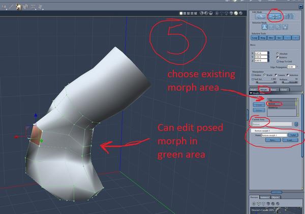

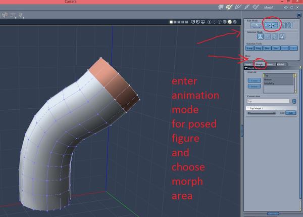

    (b) This is for rigged objects that have been posed. Morphing a rigged figure in the posed position is very flexible, and is a good reason to use generation 4 and earlier figures rather than genesis-type figures. It is also a reason to create your own posable figures and objects. In any case, create morphs for posed figures while in animation mode in the vertex modeler.
    How? Pose your figure. Select the model level and enter the vertex modeling room. The model will appear in its default position, not its posed position. In the properties tray, under the edit mode (top), choose animation mode (middle icon, looks like person with arms spread). The model will then adopt its posed position. Click on the morph tab in the middle of the properties tray. As long as you already have the morph area and a placeholder morph created, you can edit the morphs while the figure is posed. This can be a great way to correct joint bends, fix poke-through, or anything else you want. Note - if no morph areas and morphs exist, you can't create any in animation mode.

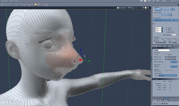

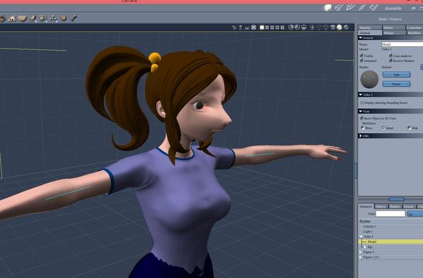

    OK - back to Aiko3 and other generation 3 figures.
    Yes, they are vertex objects (boned with skeletons attached) as far as Carrara is concerned. Even without creating a formal morph, I can convert Aiko3 to Ai-who for use in a How the Grinch Stole Christmas tribute.
    Just select the model level of Aiko3 and enter the vertex modeling room (or click the wrench to vertex model in the assemble room). I then selected some polygons on the nose with symmetry and soft select to convert Aiko3 from an anime-style figure to a Cindy Lou Who style figure (or at least start to).
