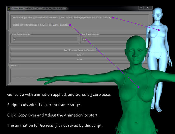

This script will, frame by frame, take the current pose from Genesis 2, make adjustments, and then apply it to Genesis 3. After it is finished, you can then save the adjusted animation in whatever format available to you in DAZ Studio.

  • Load Genesis 2 Female, be sure it's the base Genesis 2 Female by checking the scene tab, and it is named Genesis 2 Female
    Apply the animation. If the animation is an aniblock, then be sure to bake the aniblock to the Daz Studio timeline
    Load Genesis 3 Female, be sure it's the base Genesis 3 Female by checking the scene tab, and it is named Genesis 3 Female. If you are in Pose and Animate mode (Which you don't need to be), change the mode so that you can start the script).
    Start the script. (Yes, both Genesis 2 Female and Genesis 3 Female need to be loaded, with the animation applied to Genesis 2 Female before the script is started)
