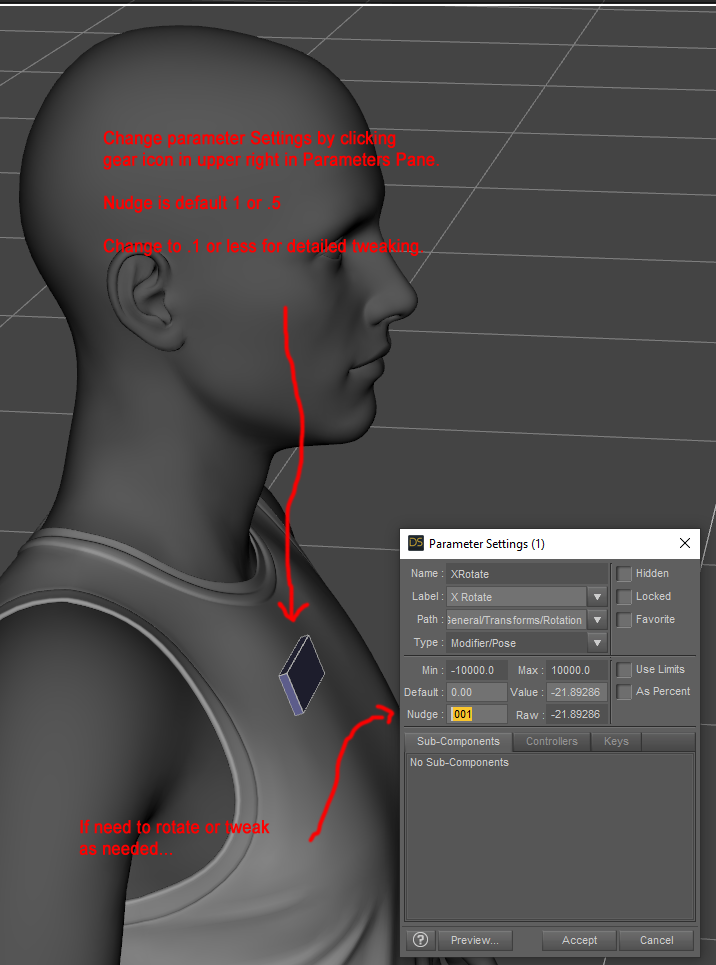

    Glad it helped.  And yes-- depending on pose, will still need some tweaking.  At risk of sounding pedandic, here is way of making tweaks a bit easier.  Change "Nudge" to smaller value than default 1 or .5
    749 x 431 - 45K
    716 x 965 - 148K
