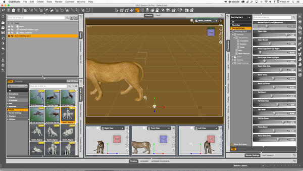

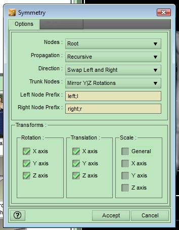

Okay, I love using Symmetry. It allows me to use a ton of poses in reverse which allows me to almost double my pose library. However, I ran into an issue with it when I tried to use it on Big Cat 2. Can anyone tell me if I'm doing it wrong?

  • SzarkSzark Posts: 10,634
    edited June 2015
    Have you tried just selecting the main top node of the cat and using Selected in the first box. All the rest look perfect to me. I found that some figure respond better when Selected is chosen while others need Root.
    PS and Keep Scale selected.
    I've done it that way first, with Selected and keeping all the scales selected. Then I found a post by SickleYield with a screenshot of what he suggested. I've included it here. Both produced the exact same result.

    Can you post the "Currently Used" from the Parameters pane?
  • MacSaversMacSavers Posts: 324
    Here's two screen shots. You will even see the pose I chose. The first one is before symmetry and the second one is after.
    1920 x 1080 - 494K
    1920 x 1080 - 506K
  • Richard HaseltineRichard Haseltine Posts: 111,788
    You are using a lot of pose controls - the ones that affect the front legs right or whatever - and those don't get swapped by Symmetry. You will need to manually swap the values for the left/right parameters that affect several bones.
