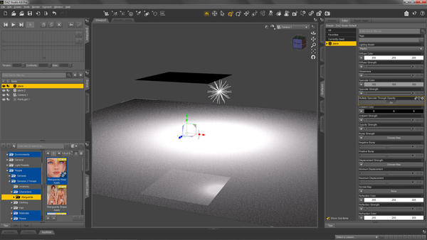

So I just opened a scene I was working on yesterday, and for some reason, iRay is now rendering very grainy. Normally on my GTX 780 Ti, the grains are gone within seconds. Now the noise is not going away at all. I have made no changes since Yesterday, other than running an overnight animation render. This is what I've tried;
1. resetting to defaults in render settings
2. creating a new scene with a simple plane and point light (see photo below)
3. making sure my 780 Ti is checked in render settings
Any ideas what the issue may be?

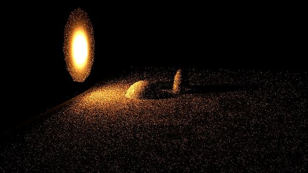

    Here is a render out to 500 iterations.
    Normally, the grain should be gone within a few iterations.
    Strange.

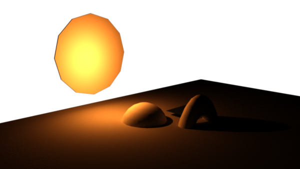

    After doing more testing, it appears this artifact only occurs when an object is reflected on a surface. When there is no reflection, then I get no noise at all; everything is smooth again. Here is another example of a simple emissive surface and a couple primitives;

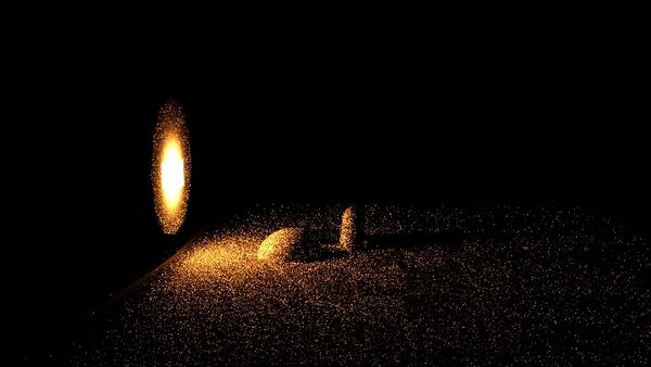

    I need your help. If you have a spare moment, can you please download the small test scene at ***this link,*** and render it to 300 samples and post your images?
    I am having a problem with grainyness / noise in iRay, as you can see in my render below (@300 samples). This problem started with my computer on June 19th, the day after the latest version of Daz was released. Prior to that day, this problem did not exist.
    I am still trying to figure out whether the issue is specific to my computer, or whether it is common to all Daz users...hence the purpose of this thread. If you can take a few moments to render this for me and post your results, I would be greatly appreciative.
    Davide
    720 x 405 - 216K
    720 x 405 - 237K

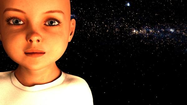

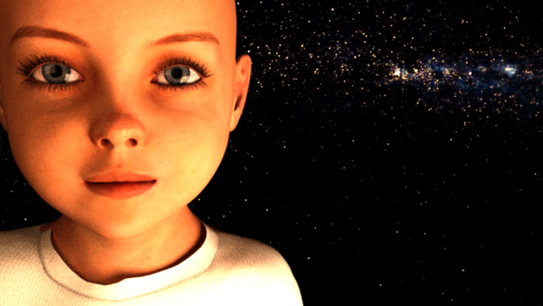

    Below is a one-to-one comparison. The first render was done on June 18th (to 300 iterations). The second render was done a few days later (also to 300 iterations). There were no changes made to the scene. If you click on the second image, you will see the grain more clearly (notice the cheeks and reflections in the eyes).
    I suspect the latest build released on June 18th is to blame....
    If you have access to an older build of 4.8, I would like to try installing it to see if the issues resolves itself.
    720 x 405 - 184K
    720 x 405 - 345K

    Would you happen to have a render of this test scene with and without the noise? I have Studio versions 4.8.0.56 and 4.8.0.59 installed and I'm seeing the same results for both.
    From what I can tell, this is a lighting issue.Plane 2 is emissive and is very bright and very small.Removing it seems to remove the noise.
    720 x 405 - 157K
    If Plane 2 is the problem...check to see if it is set to double-sided. Szark had a post about double sided emitters really increasing render times.
