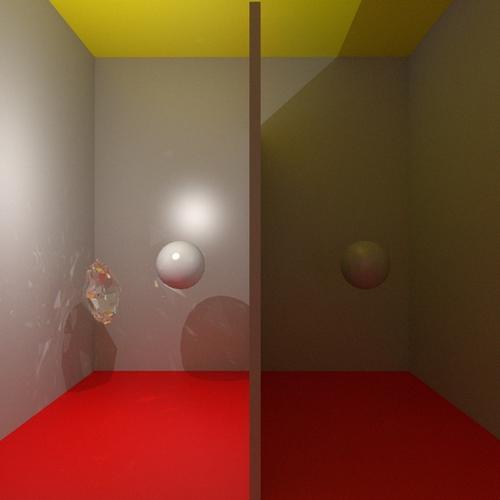

I made a simple test scene to compare Kerkythea and Iray speed. Disappointing but also informative. Iray keeps crashing my graphics card driver* and gives no perceptible speed increase. Is there some non-obvious thing needed to get the speed benefit of the gpu?
Test
Kerkythea: MLT+BPT, cpu only (it has no gpu mode)
Iray: photoreal with architectural mode and caustics and cpu+gpu.
I ran KT for an hour, saved picture, then ran Iray for an hour and visually compared pictures.
Results
After an hour of rendering the images were at about the same level of completeness by visual inspection. Then the driver crashed.
So for a GT 640 there is no gain in speed with Daz Iray for high levels of realism. A new 64 bit program using cpu plus gpu should be faster than an old free 32 bit cpu only program that is sort of a public beta test.
This also implies, though I didn't test, that Iray in cpu only mode is pitifully slow. That is unfortunate since due to crashing I'd have to run it in cpu only mode. I do like many things about it even without a speed boost.
Here is the KT image. I don't have the Iray image due to crash.
*Credit though that crashes could come from 4.8 being a beta, I think, or since my card is not to minimum specs recommended. Crashes are less frequent in gpu only. It did run for renders of two hours on other images.
700 x 700 - 161K
