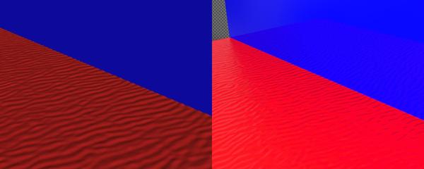

So what about displacement?
Even for objects/surfaces with a very low resolution divisions-grid you could apply very small and detailed displacement structures without any problem for the render engine (3Delight).
Now try this with iRay !!
You have to apply division densities which are similar to the structural details you want to implement with displacement. And as everybody knows very well: This drives rendertimes into eternity.
Please find attached the compare of a simple displacement structure rendered with 3Delight vs. iRay. For iRay I supported it with base bump which is, as a buddy told it, a "fake displacement". Yes he's right. Otherwise you wouldn't see any structure (right side)
Do you see the essential important difference in the line where both planes cross each other?
    Please find attached the compare of a simple displacement structure rendered with 3Delight vs. iRay. For iRay I supported it with base bump which is, as a buddy told it, a “fake displacement”. Yes he’s right. Otherwise you wouldn’t see any structure (right side)

    Displacement isn't a bug - it's how Iray works. I agree it's an annoying limitation, but if that's how the system works - presumably to ensure it stands a chance of fitting into video RAM -then it's not a bug because we don't like it.

    Please compare the displacement demonstration. I hope, you see the difference. If your surface really have a 3-dimensional structure, the render engine, whatever, must be able to reflect this correctly. Especially if it claims to be photoreal.
    How that could be coded and to take care of rendertime is the responsibility of the software-developers. But it is what you can expect for a state-of-the-art software.

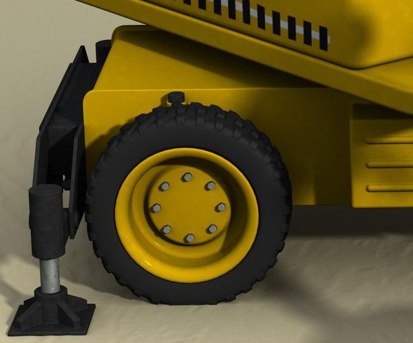

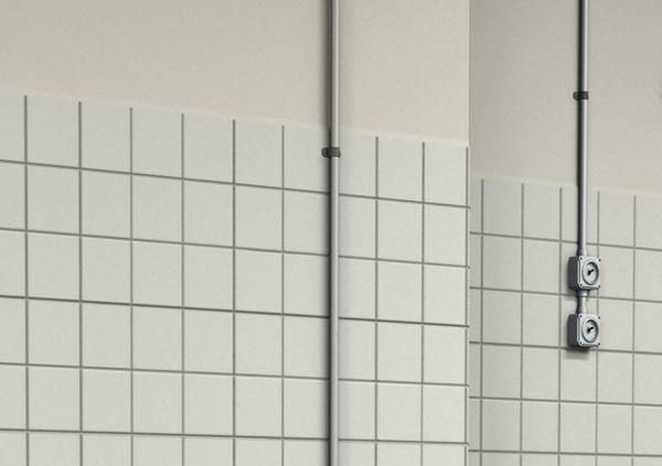

    Please find attached 2 small details of older renders. This difference of level is only performed by a suitable displace-map. All the more I expect this from a more modern software (as iRay claims to be).

    Nothing, I repeat, nothing else out there does displacement like 3Delight. 3Delight's displacement is considered to among the best, if not the best, in the industry. It does micro-fine subdivisions of the mesh, without eating every bit of RAM.
    That said, there is nothing wrong with Iray, as far as displacement goes. It just isn't doing it the way 3DL is...and frankly, it can't. Yes, you can get great displacement out of Iray...BUT, you have to manually set the subdivision levels...and set them pretty darn high. So, that would preclude most GPU accelerated renders, as there won't be enough memory to handle all the subdivision. And, even not doing a GPU render, you'd need more than 32 GB of system RAM...unless all you want is something simple with procedural textures, as opposed to image based ones.
  • AlienRendersAlienRenders Posts: 807
    Displacement maps in iRay are just plain crap. It's a well known problem that has been mentioned several times. Usually, displacement maps are supposed to create extra geometry. But since it's a map, the engine is supposed to be smart about it. With iRay, it does not subdivide anything. And you have to crank the settings up really high as to make it worthless since you're bumping up subdivisions in areas that don't need it.
    Having said that, I don't know if it's just me or if there were changes recently, but iRay's normal map and bump map handling is way better than I remember it just last week. Most of my renders look better recently too. The SSS settings look better without having to convert them. If you do convert them, it looks a bit different and gives it a more consistent look with the rest of iRay materials. One thing I don't like is the iRay skin settings for the eyes. Way too much reflection and glazed look. The regular non iRay settings look way better. To the point where I save those materials before applying the iRay skin settings then re-apply the default eye materials.
    You know, most other renderers, that aren't 3Delight have displacement similar/the same as Iray's...that is why bump and normal maps are so prevalent in the wider 3D community...you could pretty much say the type of displacement in Iray is the 'industry standard'. In other words, by having 3Delight in Studio, all these years, we've been spoiled as to how displacement works.
