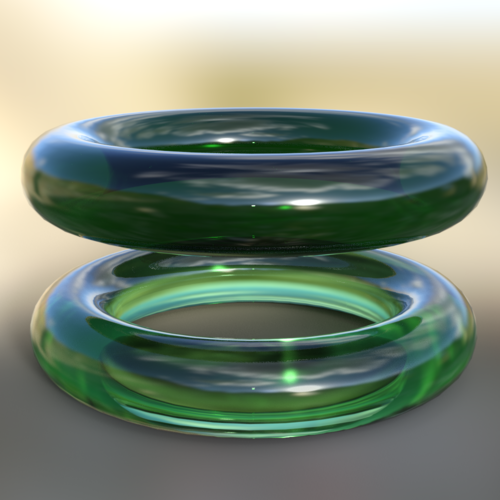

    There are two quick ways to make tinted glass with the Uber Iray shader.
    - Apply one of the "Solid" or "Thin" Glass Shaders. Set "Share Glossy Inputs" to off. Set the "Refraction Color" to your desired color and/or add a map. Set the index of refraction appropriately.
    - Apply one of the "Solid" Glass Shader presets and change the "Transmitted Color" and "Transmitted Measurement Distance" to get the desired color. Set the index of refraction appropriately.
    The first allows a map, the second is more physically correct.
  • DAZ_cjonesDAZ_cjones Posts: 661
    Here's an example of what I was talking about.
    Top is first method, bottom is second method.
    1024 x 1024 - 994K
