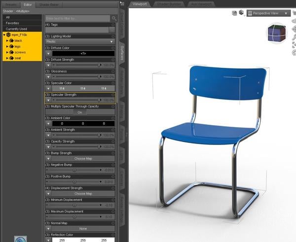

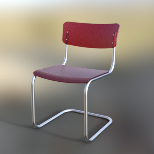

    1. Import the 3DS file into Blender. It, for once was actually the nicest, cleanest version to import into Blender, and like Takeo said, all the materials were properly defined. Then I flipped over to Edit mode. There I converted it to quads and selected a couple of edge loops around the seat and back. Then unwrapped it.
    2. I then exported it as an obj.
    3. Imported into Studio, rescaled it and saved it as a Prop Asset.
    4. Then I Googled that chair and went to a website selling them (the real chair) and looked at the colors it comes in. Then I used a color picker to select each color and in the Surface pane, for the seat material, entered each color, saving each one as a Materials Preset. Did the same for the wooden one...which was the reason for UV unwrapping it.
    Now, most of those steps can be done in any modeler that can import 3ds files.
