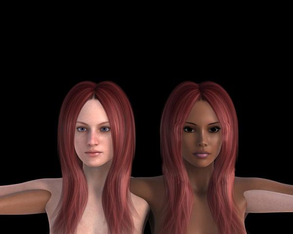

Hello,
I know this sound kind of weird but I'm having a little problem with Genesis 2 Female Hairs. For example, this regular genesis 2 female with OOT Hair is normal but when I put it on Genesis 2 (Gen X) or Victoria 6 figure the hair shape different than the original. Cuz usually when I add the hair to different figures they stay the same but now it is not. Could someone tell me if this what supposed to be or not? Thank you

    Morphs on the figure can be set to autofollow, so that they automatically get transferred to clothing/hair applied to the figure -- in some cases you don't want those morphs to get transferred, as in this case where it looks like one of the morphs in the eye area is getting transferred and causing distortions. Select the hair, and in the Parameters pane options menu (rectangle with horizontal lines in the upper corner) make sure "Show Hidden Morphs" is selected. Then you can see the morphs which have gotten transferred to the hair, and you can dial down their strength.

    Alright cool!! Thank you so much for your help!! It works now. Thanks again
