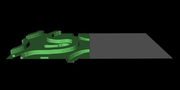

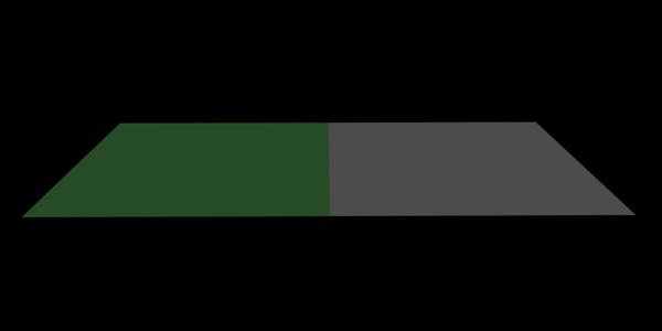

    don't know for Ca, but in DS 127,127,127 (RGB) is neutral, lower (black) is negative and higher (white) is positive displacement, as can be seen ion the 2 images..
    The 'flat' one has a RGB127 greyscale disp map, the other a pattern with base RGB127, and some White (255,255,255) and black (0,0,0) patterns
    (the grey coloured plane on the right side in the images is for reference, it has no displacement)
    Bump is the same RGB127 neutral, but opposite in the effect (white=negative bump)
