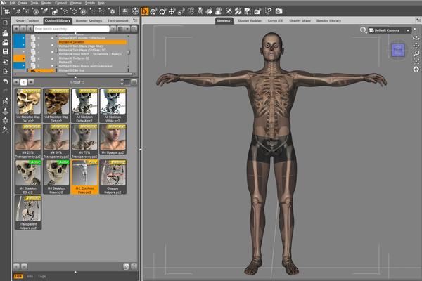

    The V4 Skeleton comes with a "V4 Conform Pose". Here's the instructions on how to conform the V4 Skeleton to V4 from the DAZ Wiki-docs.
    To conform V4 to Skeleton for DAZ Studio and Poser
    1. Load the V4 Skeleton
    2. With the Skeleton Selected apply the V4 Conform Pose
    3. Load V4 (In Poser Turn off IK for V4)
    4. With V4 selected apply the V4 Conform Pose
    5. Conform V4 to the Skeleton:
    “Fit To” in Studio
    "Conform To“ in Poser
    In Poser Only, you will have to reapply the V4 Conform Pose to V4
    I tested this with M4 and the M4 Skeleton and without the conform pose, I get the same conform poke thru issue as the OP. Here is a picture of my conforming result with M4 and M4 Skeleton using the conform pose.
    1463 x 976 - 146K

    Thanks Lindsey, a great help :)
  • stug2010stug2010 Posts: 18
    Thanks everyone, Yes Lindsey that worked perfect. It's amazing how much time you can use up just doing things wrong :)
