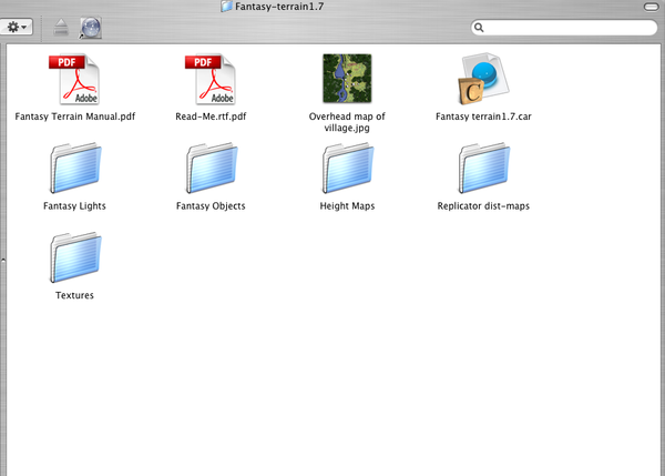

    Tim, yes, if you were to create a folder for a Carrara project, then make sub-folders for various assets such as image maps, elevation maps, etc. within the main project folder, then you should be able to move that folder from machine to machine without breaking the links/references. That's how I distribute my Fantasy Village Terrain at ShareCG.
    879 x 628 - 100K

    Excellent, thanks EP. It was when I had to scroll though 150 texture maps, masks etc to find my .car file that I thought, "I could have organised this better..."!
    When I first created that terrain and was testing it, I had done the same thing it sounds like you did. It was a PITA to fix, but compared to your scene, mine was pretty simple. I actually have more distribution maps than texture maps! My goal was to use as many procedural textures as possible. I'm particularly proud of the wooden fencing that I made.
    I was putting this off, anticipating a tedious job of keep browsing to the new texture folder. Anyhow, this arvo I gritted my teeth and went for it. Copied all the texture / mask files into the subfolder, then launched Carrara and opened the project.
    The first dialog came up, asking for the path to a texture. Click - click - clock - okay - wait . . .
    The next dialog never happened! That was it: Carrara figured out for itself that all the other textures were in the same place, and it just all worked. :) Happy bunny! :)
