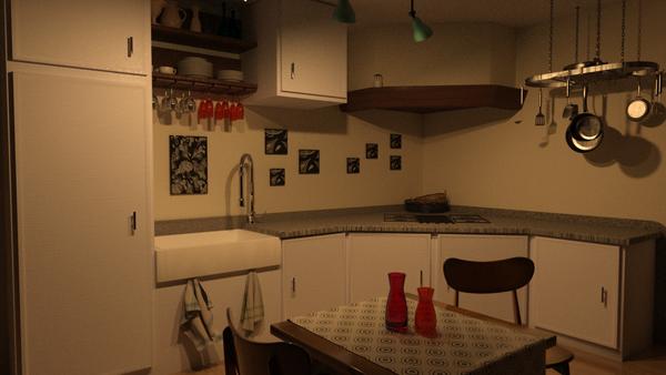

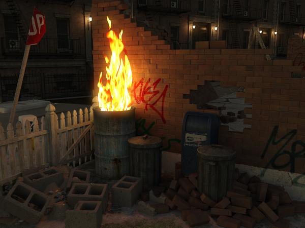

Thought I'd start a thread to let everyone show off their Iray lit renders, and share some ideas on how it was accomplished. To start off, I'm going to start off by giving away a freebie and a quick tutorial.
Here's what you get, a fire object and flame texture map: http://www.mediafire.com/download/a2q2c440r48212q/DzCampfire.zip
First, open any environment (I used the Behind the Neighborhood) and import the fire.obj model into your scene. Apply the DzCampfire.jpg texture map into the Diffuse channel in the surface tab.
Now, if you have them, look in the 'Iray Real Light' in your Shader Presets tab for Monitor Screen shader. Using the surface selection tool, select the fire prop. Holding down the ,ctrl. button, apply the shader to the fire prop. You should now have a fire that emits light now.
To clean it up for rendering, we need to scroll down in the surfaces to the Emission Color and apply the DzCampfire.jpg into it. We will also apply the same texture map into the Luminance (cd/m^2) channel. At this point, the fire is ready to render.
To render your scene out at night, open the Render Settings tab. In the Environment settings under Environment Mode, select Sun-Sky Only. Turn on Draw Dome, and change SS Time to a good night time (I used 3 am).
Render ;)
650 x 500 - 248K
Post edited by DzFire on

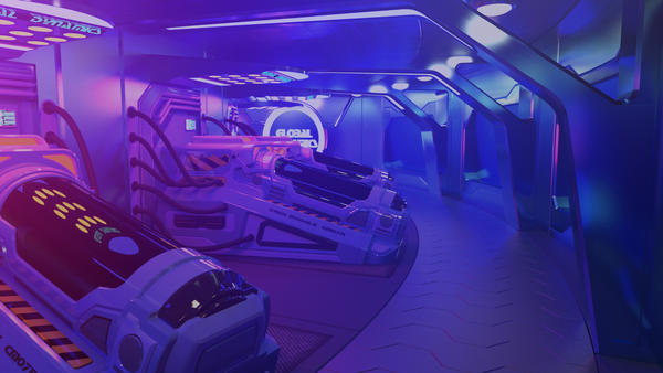

  • DzFireDzFire Posts: 1,473
    "Dropping in" lit entirely with light emitter shaders
    1850 x 1000 - 1M

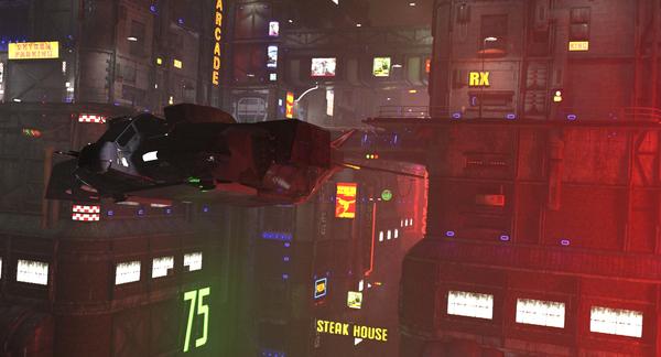

  • aaron575aaron575 Posts: 146
    edited June 2015
    Just finished this one, also done only with emitter shaders. No postwork.
    Edit. PS. Thanks for the freebie DZFire. :-)
    1920 x 1080 - 913K

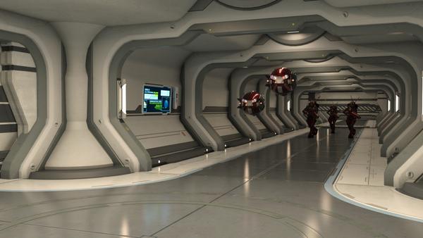

  • BTLProdBTLProd Posts: 114
    Tips and tricks. :)
    OK. Grab all the light materials in Utopia Deck C.
    Apply the Fluorescent 60 watt to them all.
    Change the luminance units to cd/m^2.
    Select the ceiling lights and turn off 2 sided light.
    Select the Monitor Screens and Ctrl-Click the Monitor shader, keeping the textures.
    Copy the diffuse texture to the Emission Color channel.
    Do the same to the lights on the drone.
    Under render settings, under filtering, turn on bloom filter.
    Adjust Tone mapper to taste. :)
    For full size image: http://www.daz3d.com/gallery/#images/72848
    1280 x 720 - 149K

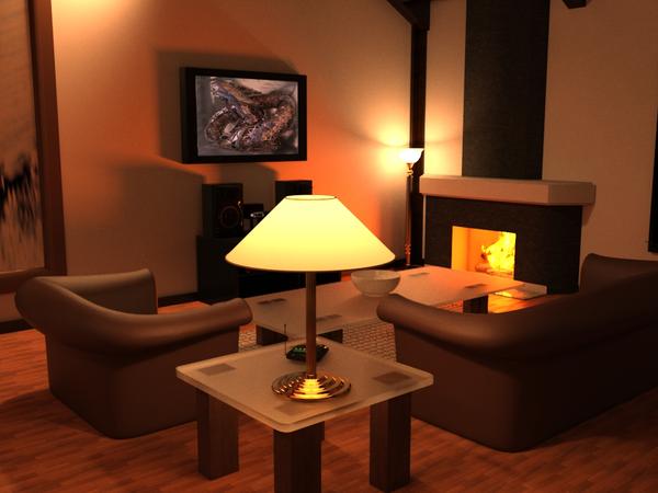

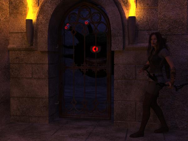

  • RarethRareth Posts: 1,462
    lots of uses for the campfire light, torches.. fire places
    it's very handy
    1024 x 768 - 585K
    1024 x 768 - 482K

    Here is my picture with the campfire.jpg. I turned on the Bloom filter. The settings I used (chosen by experimentation):
    Bloom Filter Radius 0.08
    Bloom Filter Threshold 20000
    Bloom Filter Brightness Scale 0.05
    I set my sun/sky to 6:30 pm at latitude 28 in June to get some ambient light to show the urban background (Stonemason's Streets of NYC Townhouse Row).
    Edit: The lights on the building have the 100 W bulb light applied.

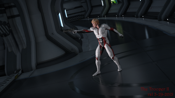

    This is from way back in the beta. I'd probably do better with it at the moment.
    2 spotlights to illuminate the figure. Everything else is lit by emitters.
    I used Tone Mapping to get the right exposure, but this is one of the few times where I used the global Cm2 factor slider to squeeze some more light out of the sources.
    Its better if you see the full size version in my gallery
