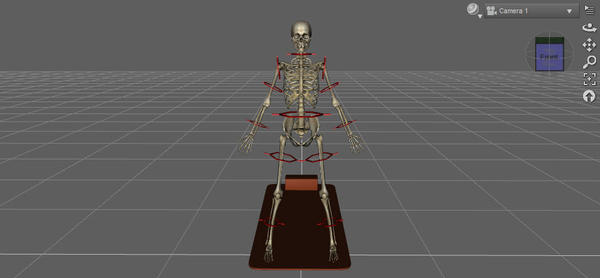

I'm sure that is not the right name but I am animating the v4 skeleton and it has these hexagons on the limbs. But they also show when rendering. How do I hide them. I have attached a pic which might make more sense than me
953 x 441 - 55K
    They're "Helper" handles that make it easier to drag the body parts around for posing, you select them instead of the various bones. If you can find the materials for the Skeleton, two of them control the helpers, named "Opaque Helpers" and "Transparent Helpers".

    Thanks SpottedKitty. How do I hide them when I want to render?
  • Richard HaseltineRichard Haseltine Posts: 111,332
    Select them and in the Parameters pane, under display, turn Visible in Render off. You can also turn Visibility off, but that will hide them entirely which may not be desirable while posing.
  • stug2010stug2010 Posts: 18
    Hi Richard, thanks. It didn't seem to work like that somehow when I hid the helpers in the render it also hit the body parts. I have got around it by removing the helpers, but of course then they are not there to help.
