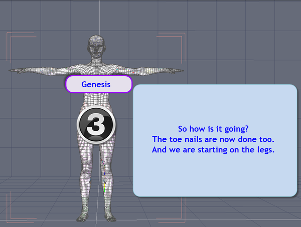

    After the fingernails are done, the toenails are done in a similar fashion ... just to be sure the toes are in the right order.
    I've started on the legs.
    1068 x 807 - 103K
