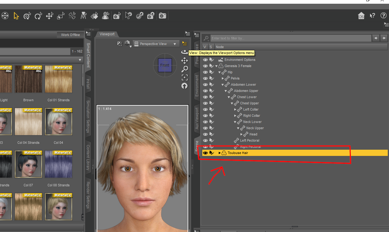

    First the hair must be selected in the Scene Tab

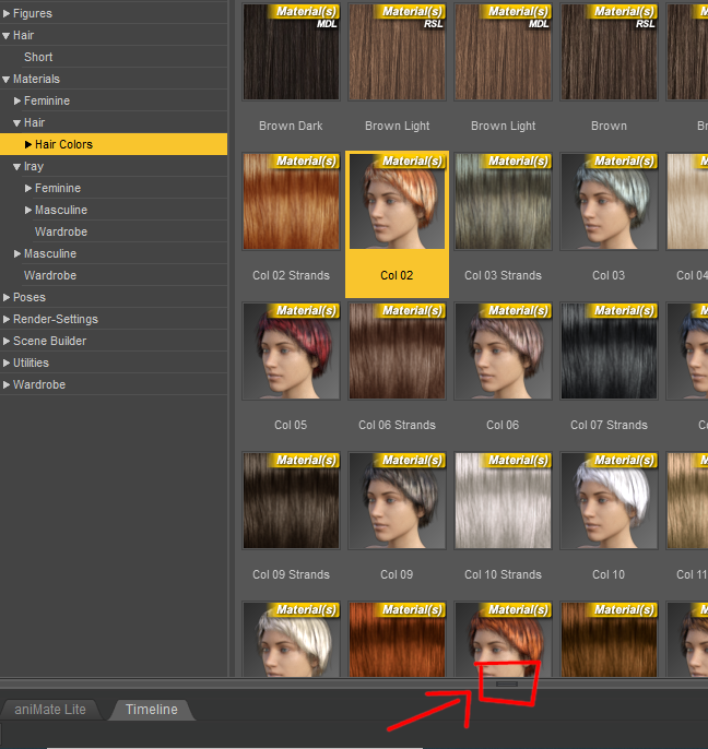

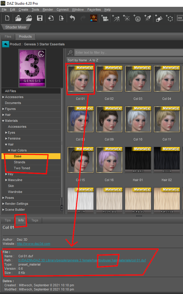

    Then you have to look under Materials --> Hair --> Hair Colors --> and click on Base, Strands or Two Toned. DON'T look under IRAY, because there you will find the ARMANI Hair colors, which won't work with Toulouse Hair. If you click on "Hair colors", there will also be Armani Hair Material Presets shown to you. You can always find out if the materials are for your hairprop by looking at the INFO tab (image below): Here the example is "Col 01" which is inside the Toulouse Hair folder.
    If you can't find the Tips/Info/Tags Tab you can open it by clicking on the tiny little rectangle (image):
