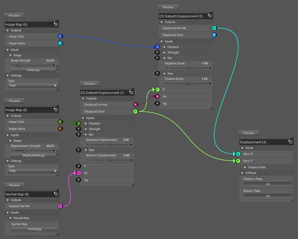

    For those interested, I managed to get the imported Shader Mixer shader to behave and render identically to the original shader. I have not tested it thoroughly, but it works for the example in this thread. Here's what had to be changed:
    1. The first DS Default Displacement brick (displacement & normal map) should not pass Nn to the second DS Default Displacement brick (bump). Instead, the second DS Default Displacement brick (bump) should take the normal map as an input for Nn. In the attached shader network (which is as imported from the scene), this means the output of Normal Map (9) should be connected to the Nn input of DS Default Displacement (5).
    2. Set the Bump Strength to 100%.
    3. Multiply the Negative Bump and Positive Bump parameters by whatever the user had set the Bump Strength to originally.
    4. Set the Displacement Strength to 100%.
    5. Multiply the Minimum Displacement and Maximum Displacement parameters by whatever the user had set the Displacement Strength to originally.
    6. Swap Minimum Displacement and Maximum Displacement parameters to fix the inversion that occurs.
    The Shader Mixer network should now behave exactly as the original network did.
    Thanks again to everyone for taking the time to post & help figure this out. Hope this saves somebody some time/headaches!
    - Greg
