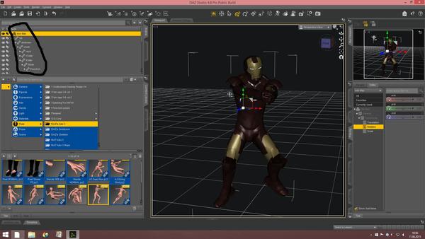

    Make sure you select the nodes marked with a tringle (in the Scene tab) not the ones marked with a cube. If you select the ones with the cube you only move the armour parts. If you select the ones marked with a triangle you move the whole body part.
    You also can select the one with the three cubes (at the top of the Scene) wich select the whole figure and than select a pre-made pose from your Content.
    1920 x 1080 - 253K
