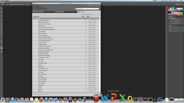

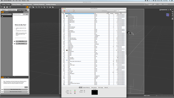

    First, there is no files in the vlog folder and I enclosed another screenshot showing activity monitor and what i see when I start DAZStudio
    Also, you asked me if I start by scripts, so, because I dont know how to start by using a script, I suspect the answer is no.
    I cant believe I am the only one having this problem on the entire planet. I wonder how everyone else is fixing this problem.

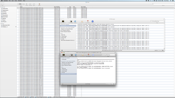

    OK, I went back into the blog folder and there are so many vlogs in there that it locks up my funder (spinning beach ball) every time I try to go in.....I mean there are millions of log files in there.....why so many?
  • edited December 1969
    Here is what the VLOG folder looks like and its generating another vlog almost every minute
    1990 x 1119 - 1M
  • TotteTotte Posts: 15,255
    edited June 2013
    It's pretty clear, it says "cannot open Master Database".
    So, in the CMS folder, in Databases, can you show whats in there.
    You can use the terminal
    (1) Start the terminal
    (2) type ls -ls Post the results here.
    I guess either the permissions prevents the CMS from being installed, or the database is wacked.
    If wacked, uninstall the CMS, remove all traces of it, reinstall it (by installing latest DIM or DS), then in DS do "reimport metadata".

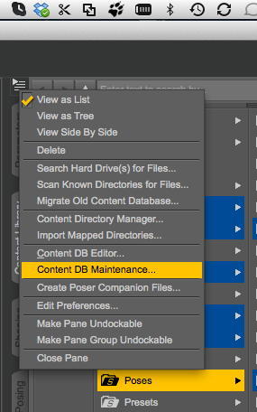

    OK, your database is very empty. Nothing seems to have been stored there.
    If you in DS try to Reimport Metadata, does it do anything?
    285 x 456 - 44K
    I am busy clicking on everything here but dont know how you got that pull down menu
    Select the TAB Content Library, then click in the menu icon just where the menu s topleft corner is in the screenshot.
  • edited June 2013

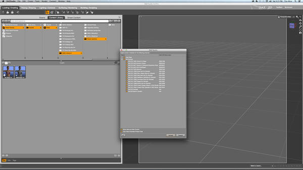

    Here is what I have to work with
    1990 x 1119 - 518K
    Post edited by timothyawise84_326aa8f1d1 on
    here is what I selected....see enclosure, but there is still nothing in smart content

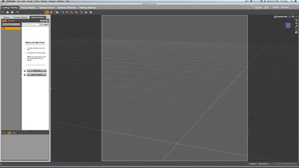

    1990 x 1119 - 189K

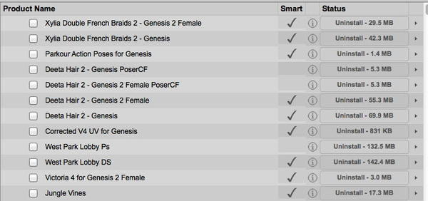

    how does one know what content has meta data????
    They have a checkmark in the Smart column in DIM.
