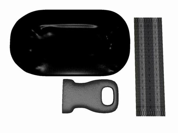

  • 3DAGE3DAGE Posts: 3,315
    Hi Turk :)
    here's a car file which should provide you with a starting point to create those materials.
    the trickiest part to plastics and vinyl is the lighting in your scene and the shape (wrinkles) of the material which pick out the light.
    hope it helps
    https://dl.dropboxusercontent.com/u/7907045/exampleshaders.car
    640 x 480 - 24K
