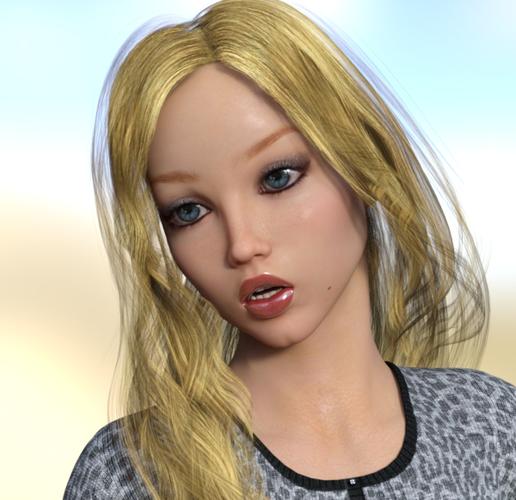

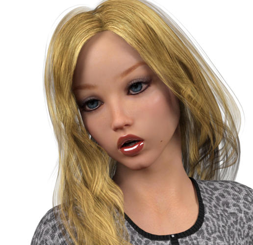

    One of the problems I'm having is not the amount of light but the quality of how it is lighting up the scene. It even seems to be affecting the way the character's skin looks. For example, here are two renders. I turned everything off in the scene and zoomed in on the face. First render is with the default HDRI that comes with Iray. I love the way her skin looks in this shot. Second scene is with 2 mesh lights. Notice how much more orange her skin looks? Her also looks flatter. Yet I did nothing to her at all -- I did not change anything but switch from dome only to scene only.
    Now, I did not mess with the mesh lights to make the angles perfect, I will admit that... but the HDRI gives so much more even, graceful light, I really would like to use it indoors, but doing so does not seem possible. And the frustrating thing is, it would be if only I had the option to tell the walls not to cast shadows, like we used to have. Argh!
    My issue here is not exposure or even shadows. It's that the mesh lights are having a dramatic effect on the "skinning" of the characters... skin surfaces that look like skin in HDRI look more like plastic or rubber to me in mesh lighting, even when the character's surfaces have not been altered at all. It just seems like there is no substitute for HDRI, and I was hoping that there would be some trick to getting HDRI to work on an enclosed set. But since there isn't... I guess I will have to keep playing around with it.
    Hm, in studio photography they use softboxes, which are comparable to "mesh lights" to make the plasicity and the contrasts of the models look way softer. And this is what happened in your scene, too. If you want to have it comparable to outdoor (hard sunlight) you have to use extra spotlights.
    And the question of color: It depends on the color-temperature parameter and surface color you used for your mesh lights. So shift it to temperatures > 6500 K.

    Additionally, the second picture I have with the mesh lights was done in an empty room with two white colored, 6500k temperature lights. Plus it is not only affecting her skin color, but also its apparent translucency and SSS.
