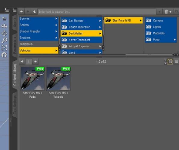

I want to Export Star Fury MKII as a Cr2. This shouldn't be a problem even though the DUF is a prop. The problem is when I go to export I only export the Pads or the Wheels.
Checking again there seems to be no STAR FURY Prop!!
What are my options?
I've attached a Screenshot
629 x 529 - 55K

    This is probably because the main ship is a rigged figure, not a static prop. Are you sure you're looking in the right folder for the main figure?

    A search brings up lots of material files, pose files, camera files and two prop files. One prop file for pads and One prop file for wheels.
    Here is the thing. I can load the Star Fury Mk II. It shows up in my pane just fine choosing either wheels or pads. I believe it's because it's two different versions of the same model. Pads for the future and wheels for the present. Cool. Very Cool.
    But why can't I export it the same way I exported SCI-FI marina? The marina had lots of different mini props. They all showed up. They all exported.
    It's frustrating.

    CR2 export works on only a single selected item, not a parented hierarchy - or are you trying to create a PoserCF CR2, rather than an actual Poser character file?
