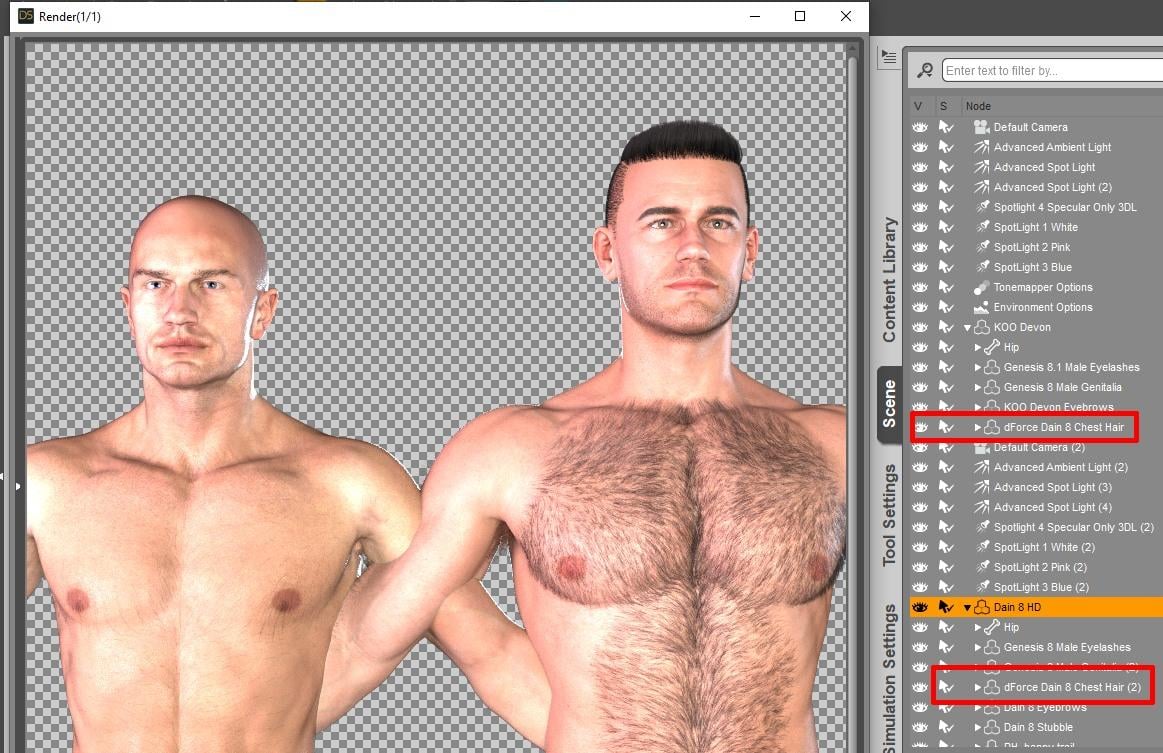

    I think some sort of bug has been introduced into the dForce strand hair, but I don't know what it could be. Below are Devon G8.1M and Dain G8M side by side with Dain's chest hair on both, as can be seen in the scene menu to the side. This is a screen capture of a render -- the "Render" window title can be seen at the top. The chest hair has been set to the heaviest density and darkest color on both Dain and Devon; Dain looks positively furry, and Devon looks like he doesn't have anything there at all.
    dain chest hair issues
    It probably needs a bug report, but I don't exactly know what to say on it. (EDIT: Ticket has been filed. Heaven only knows what they'll make of it; this is one of the more odd errors I've seen.)
    Just as an experiment, I tried using the body hair from Jepe's Roderick on Devon.That hair, like Dain's, is strand-based, but it is NOT dForce. That hair shows up in scene and on render without any issues. (Apart from the fact that it was made specifically for Roderick, so it isn't in quite the right places on Devon, as Roderick is both wider and taller, and making it fit is a pain in the rear.) So whatever is going on, it's specific to dForce strand-based body hair.

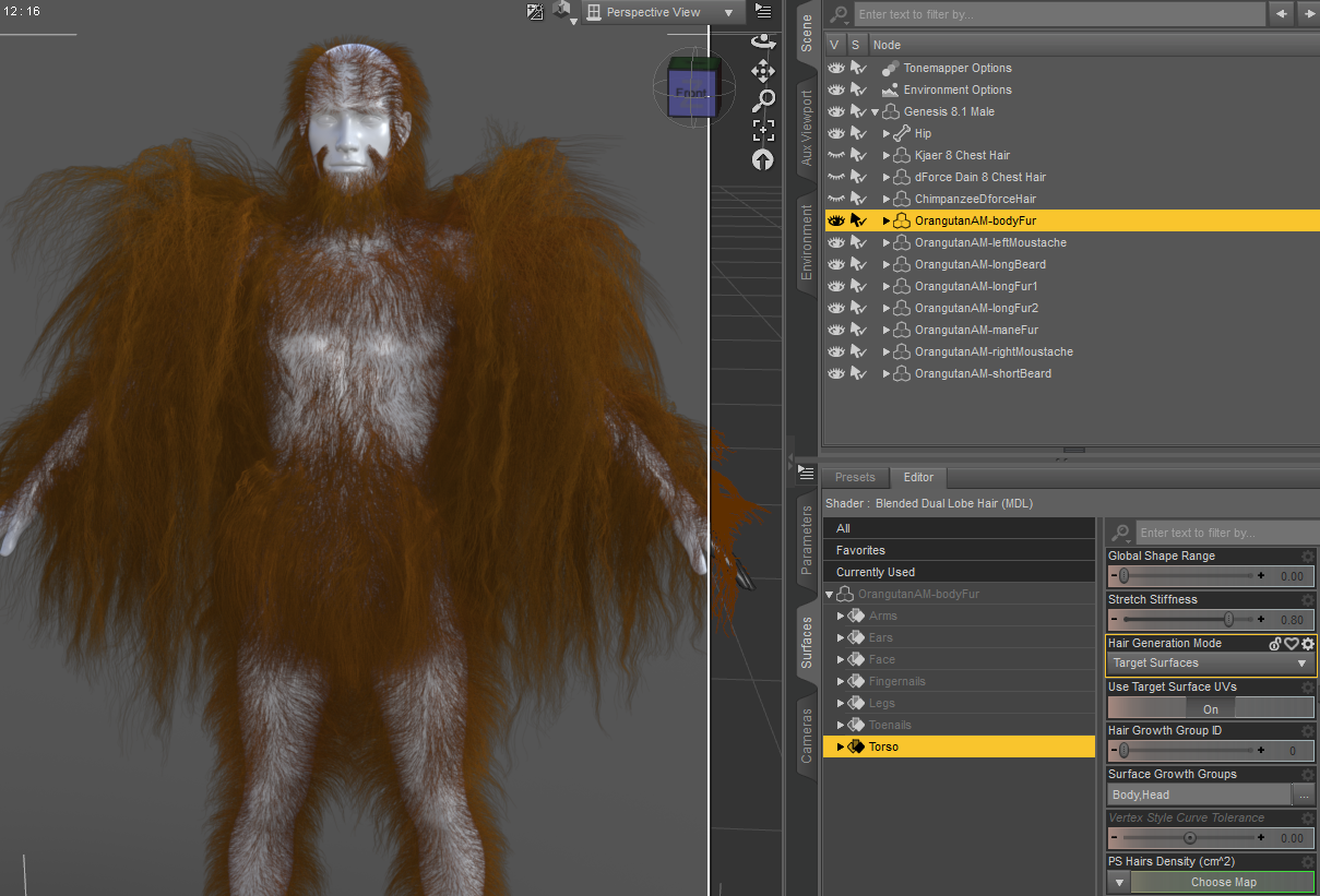

    I actually just found a one-step fix for this issue: go to the surface settings for Kjaer's chest hair, and in the box labeled Surface Growth Groups, replace Torso with Body.
    195 x 161 - 10K
  • GordigGordig Posts: 10,799
    edited March 2025
    If the hair encroaches on the head surface as well, you want to put Head and Body in that box, separated by a comma, but NO space.
