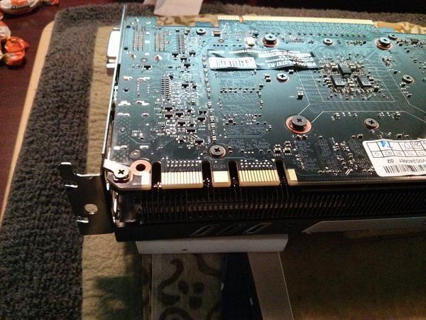

    Not just yet, I got it installed but couldn't find the extra power inputs so I went ahead and powered up and sure enough the message was "please plug in the power inputs" but I don't see them on the card. On the other side it looks like there are a couple of flat bits but I don't think I have anything in my rig that would make use of them in the way of power. Here's a screen grab of what I THINK might be the power port but again I have nothing on this rig to support that.....
    HELP!

    Wow... I took a stupid pill this AM... I found them but there are the two as you expect, side by side but one is a 6 pin and one is an 8 pin input... Typical square design. How the hell did I not see those. I tuned that card around 10 times ..... right in front on my nose.... LORDY

    Better it be user error than "why do I not have all the parts" . Especially on Sunday morning. Truth is I'd have no hope of installing one by myself at this point. It has just been too long since I fiddled with any of that stuff.
  • RAMWolffRAMWolff Posts: 10,384
    Took me a while to figure out but apparently I'm not as estúpido as I thought I was.. The little 6 pin power connectors had some two pinned ones tied down out of the way. Once I shown a good light and got a small pair of scissors out to free them up, I put the two pinner at the end, last block, lined up with it's mate and crossed my fingers. Up it came. Of course NVIDIA had to install drivers so I had the usual LARGE everything. Two monitors with a very full desktop so you can imagine the mess. I am noticing the over all viewing experience is a bit smaller so more room. I guess I need to go into the settings and fiddle around a bit more. Here are it's specs as reported by NVIDIA panel:
